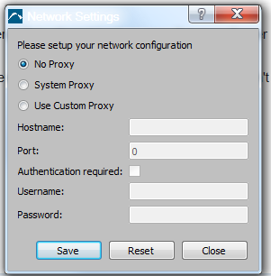

Do you use a proxi server? Under "FRIENDSHIP SYSTEMS | tools" in the start menu  you can find a little program to configure your proxi, if you use one. I assume you are connected to the internet when you try to start CAESES.
Hope that helps
