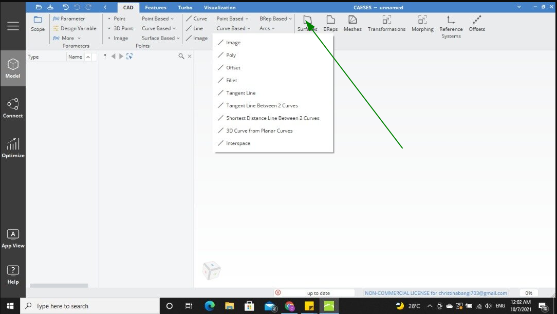

Christina 0 Report post Posted July 9, 2021 Greetings. I am currently using a non-commercial CAESES software for my ongoing project. However, I could not find the command on lofting. Here's my question. 1. Is it because I am using a non-commercial CAESES? 2. Is there any other command/method that I can use that is similar to lofting? Thank you in advance. Share this post Link to post Share on other sites

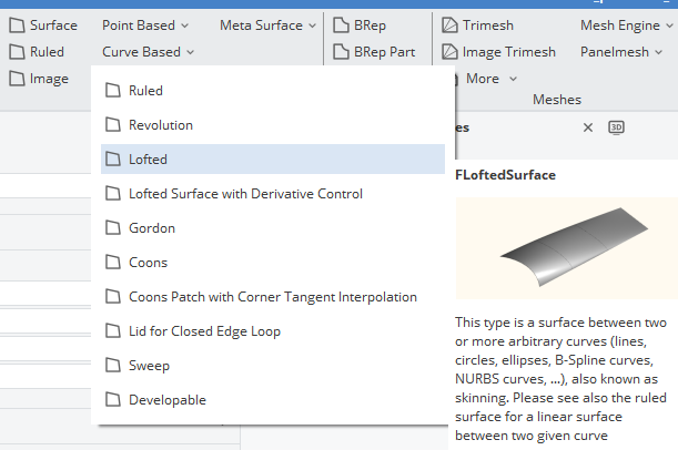

Mr. Heinrich von Zadow 12 Report post Posted July 9, 2021 Hi Christina, if you are working with the latest (currently 5.0.6) version of CAESES, you should find lofted surfaces in the category of curve-based surfaces: I am not aware that this is excluded from non-commercial packages. apart from lofting you might want to take a look at sweep surfaces or, if non of the "standards" works for your application dig into the topic of meta surfaces. Cheers, Heinrich Share this post Link to post Share on other sites

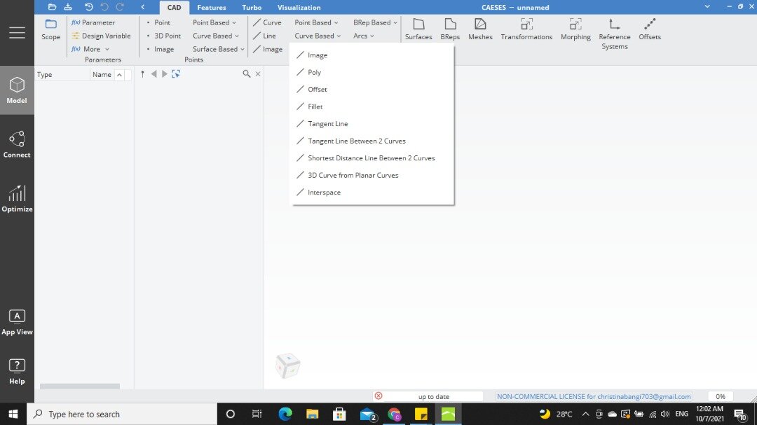

Christina 0 Report post Posted July 9, 2021 Dear Mr. Heinrich, It seems that I do not have the feature. What would you suggest me to do? Thanks. Share this post Link to post Share on other sites

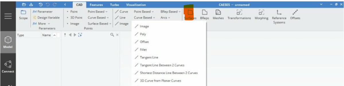

Mr. Sebastian Uharek 1 Report post Posted July 12, 2021 Hi, please try looking under the surface icon. Best, Sebastian Share this post Link to post Share on other sites
Mr. Heinrich von Zadow 12 Report post Posted July 12, 2021 Hi Christina, you are looking at curves, not surfaces (both have a category "curve based"). On your screen it seems that surfaces are collapsed: If you are on a small screen this is probably fine. Otherwise, you can change the font size by pressing ctrl and scrolling the mouse wheel. Best regards, Heinrich Share this post Link to post Share on other sites
