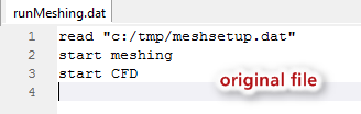

Consider a simple input file which contains a path to another file, and I want this path to be the current design directory during an optimization. post-8-0-03958400-1378987246_thumb.png

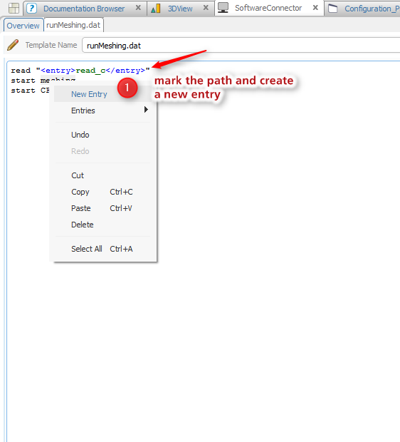

Add this file as input file at the software connector and make a double-click on it in order to edit it. post-8-0-10461200-1378987365_thumb.png

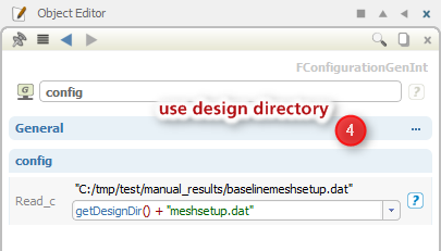

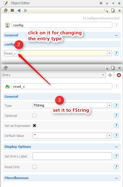

Add a new entry for the absolute path. Change the entry type to FString post-8-0-11748300-1378987503_thumb.png.
Use the command
getDesignDir()

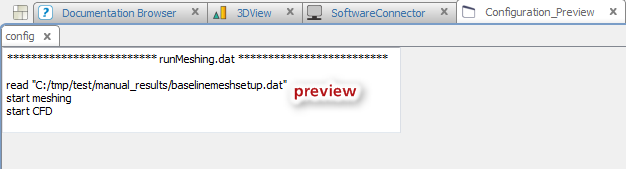

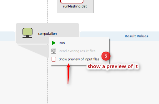

Show a quick preview of your new entry. post-8-0-63792200-1378987713_thumb.png
Here is the preview: post-8-0-77114700-1378987815_thumb.png

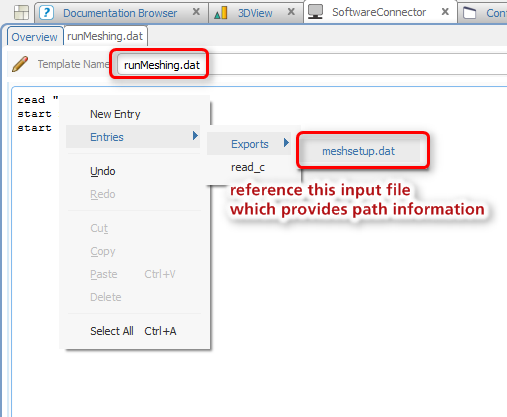

Another thing:
If you have an input file that gets copied by CAESES/FFW to the design directory automatically, you can also reference this file directly:
