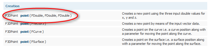

  • You can create any object by using the console instead of using the menu entries. For instance, a point with name "start" gets created by entering
    point start(1,1,0)
    • The documentation browser gives you all creator commands for any type.
