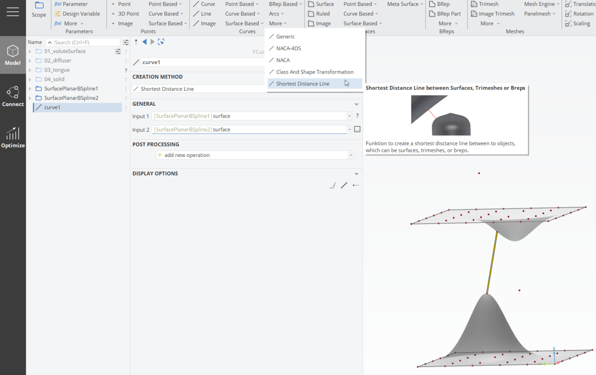

Mr. Carsten Fuetterer 9 Report post Posted February 8, 2021 Hi Rohan, yes this is possible. You can create a shortest distance line: Best regards Carsten 1 Share this post Link to post Share on other sites
Mr. Heinrich von Zadow 12 Report post Posted February 8, 2021 Hi Carsten, didn't know that, I guess this is new with CAESES 5 -- thanks for filling me in. Cheers, Heinrich Share this post Link to post Share on other sites
