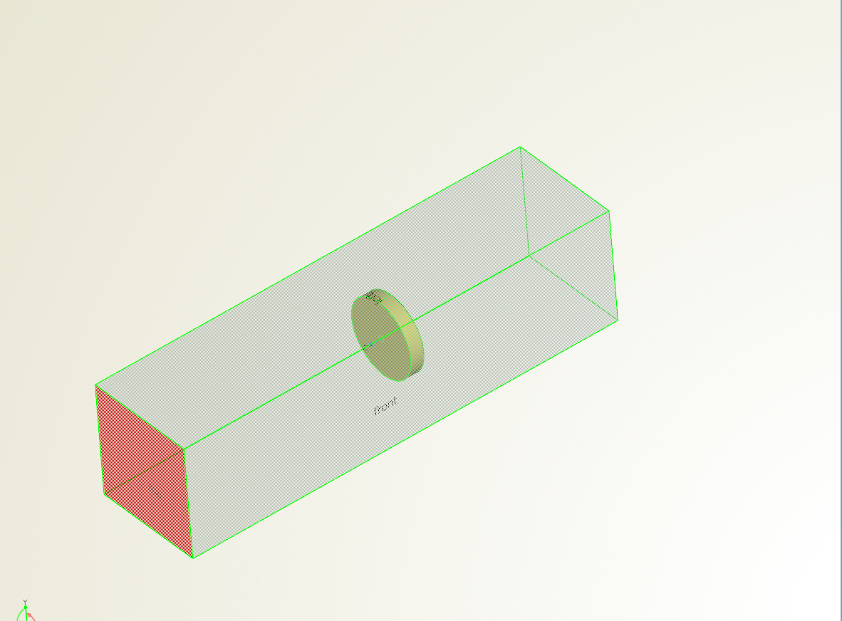

Armagan 0 Report post Posted November 18, 2020 Hello, I work on Three blade wind turbine. On three blade my mehing element reaches high number. Hence, I would like to do periodic boundary condition. I already have a flow enclosure as shown on the photo in the attachment. I would like turn my domain box model to periodic enclosure. Is there any short way to do this in Caeses or should I use boolean command after I designed my peiodic enclosure manually. Thank you in advance Share this post Link to post Share on other sites
Mr. Heinrich von Zadow 12 Report post Posted November 18, 2020 Hi Armagan, firstly, from a CFD viewpoint I'd recommend you to go for a cylindrical domain, especially if you are going to split it into just a segment. I'd probably just create a domain-segment of 120° and then substract the wind turbine from it via boolean op. BR, Heinrich Share this post Link to post Share on other sites
