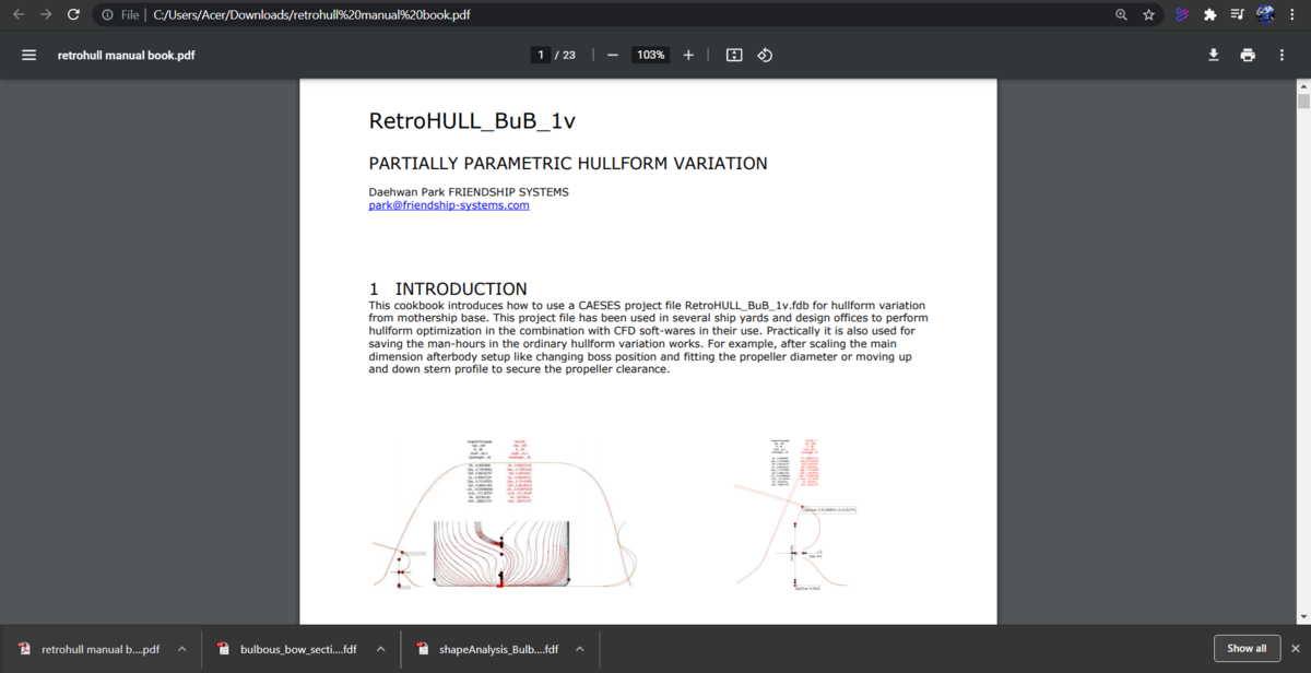

I have been discovering several samples and tutorials for ship hull optimization. I'm a little bit confused about the use of delta shift and lackenby. I hope you dont mind to give a little bit explaination about the differences of this two features.

Hye, i'm new with this software and I'm currently doing final year task on optimizing hull form of fishing vessel. Can anyone give me some guidance to optimize hull form of fishing vessel towards reducing ship resistance with constant displacement and constant center of buoyancy? And which tutorial you prefer me to refer for completing my task?
