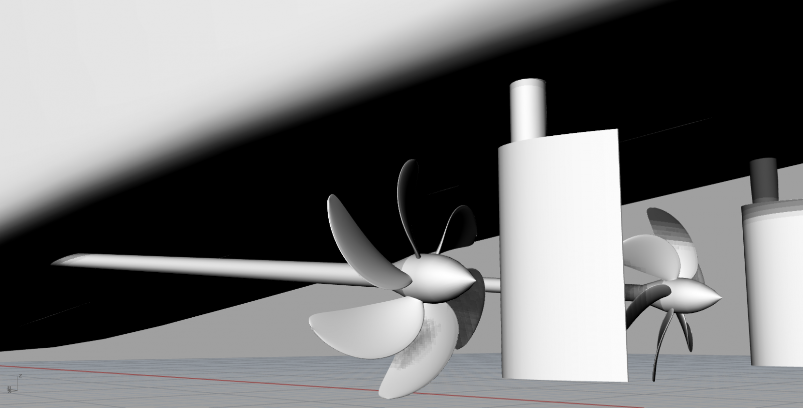

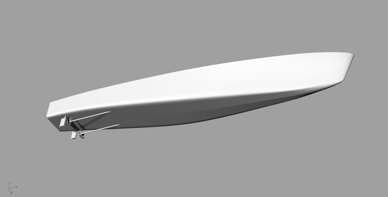

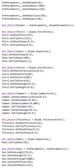

I should tell you that I have developed a C++ program to design ship hulls, propellers and rudders by parameterization approach. I’ve actually applied my own method in propeller designing module of this program, and there are no such issues. In other word, my program provides a design space rather than a tool just offering the ability of moving the control points. By supporting this design space defined by 26 parameters, my program is able to use, say Genetic Algorithm, for searching the optimum answer without produce any non-applicable models.

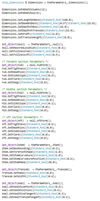

By the way, I have plenty of ideas to improve your software. Enclosed you can see some of my program's results.
And here are parameters:

Technically, the example from the video just shows one way how you can define the distribution of profile parameters in radial direction by means of nurbs curves. CAESES is just a platform and you can put constraints on any entity you define, e.g. the values of control points. but you can also use any other mathematical description for both the profiles and their radial distributions. Typically we and our users define parametric models, that would take inputs similar to those you are using, depending on the product that is being parametrized.
