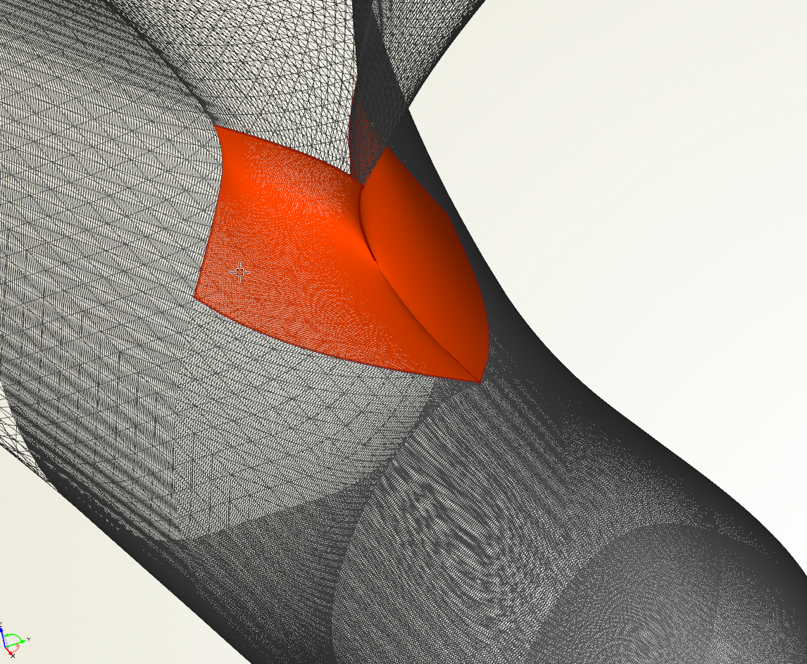

Ms. Lenja Buennemann 0 Report post Posted May 24, 2016 Hello everyone, I made up a full parametric design of a yacht with the help of your great tutorials. The only part, I'm not really happy with, is the filling between bow and bulb. As you can see in the attached picture the surface has not the right entry angle at the center line. I created this surface by the use of a Coons Patch. Do you have any better idea to define the conjunction between bow and bulb? I would be very grateful for your help. Best regards, Lenja Share this post Link to post Share on other sites
Mr. Carlo Pasquinucci 1 Report post Posted May 24, 2016 Hello Lenja. I think I have two ideas.. First, I suggest you to create a planar surface in the y-plane. Then, the first idea is a little complex. You have to create a metasurface. You can fin an idea in the sample "Fillet Surface". That is bewtween two surface, but you can modify it in order to be fillet also with the other two surface. The second idea is to fillet the vertical surfaces, then fillet this fillet surface with one orizzontal, then with the other planar. Maybe it would be better to reduce a little the domain using an image surface with domain [0,0.8]. Can you try this second idea? If it is not clear, just re-answer. Cheers. Carlo Share this post Link to post Share on other sites
Ms. Lenja Buennemann 0 Report post Posted May 24, 2016 Hello Carlo, I think I'm not really sure, what you mean with vertical and horizontal surfaces and the planar surface in the y-plane. Is there any opportunity to mark the surfaces in my picture above? Thank you in advance, Lenja Share this post Link to post Share on other sites
Mr. Carlo Pasquinucci 1 Report post Posted May 24, 2016 Hey Leja,it was not so clear.I attache a picture. I think the best idea is to create surface like the number 1, then create an image of the number 1 and the number2 with a domain [0,0.8] in "z"direction (I don't know if it is u o w direction, sorry)Then fillet this two image surface.Then fillet the result with the number 3and then fillet with the number 4 Or maybe you can work with two or more more little surfaces. If you can attach the project, maybe only that part, can be easily for us to help you. Or you can send via email also with password. Thankyou and have a good jobCarlo Share this post Link to post Share on other sites
