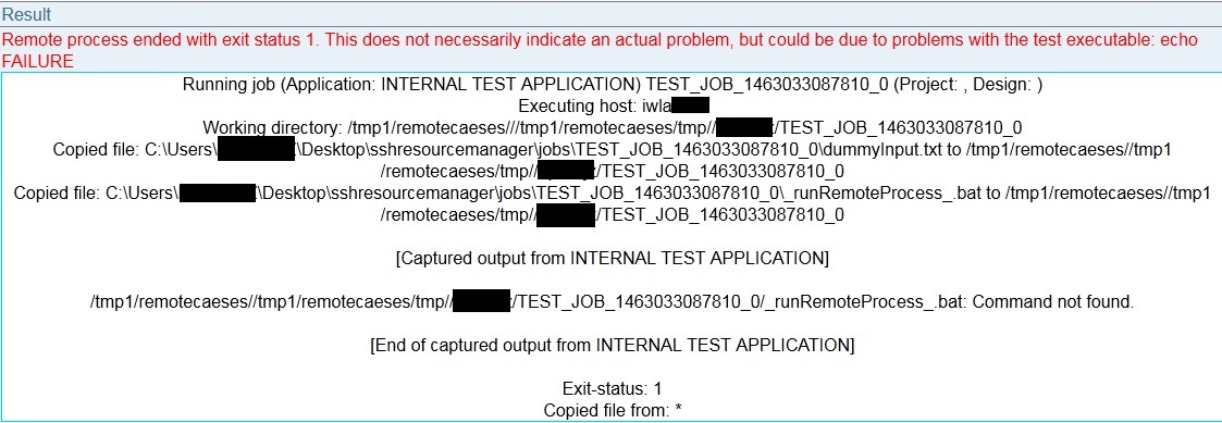

Mr. Neukam Johannes 0 Report post Posted May 12, 2016 Hello, thanks to your help, I was able to run CAESE Trial Version succesfully on my local machine (Windows 7). Now I would like to send the jobs over to my linux Workstation for computation and found the sshmanager software. I read the manual to set it up and while the temp folder is succesfully created on my linux workstation, the testcase fails. The configuration I use looks like this: Where may I find more information to figure out, why neither the testcase, nor my actual optimization runs on a remote workstation? kind regards, Johannes Share this post Link to post Share on other sites
Mr. Konrad Lorentz 2 Report post Posted May 12, 2016 Dear Johannes, Please modify the SFTP Root to "/" instead the long one. The folder /tmp1/remotecaeses/tmp exists and is writeable for the user? It may be a problem of writing the _runRemoteProcess_.bat file... RegardsKonrad Share this post Link to post Share on other sites
Mr. Neukam Johannes 0 Report post Posted May 12, 2016 Hi, the switch to / instead of the previously specified folder did the trick. For everyone interested: Put / to sftp root. And specify your working folder via tmp dir. kind regards,Johannes Share this post Link to post Share on other sites
