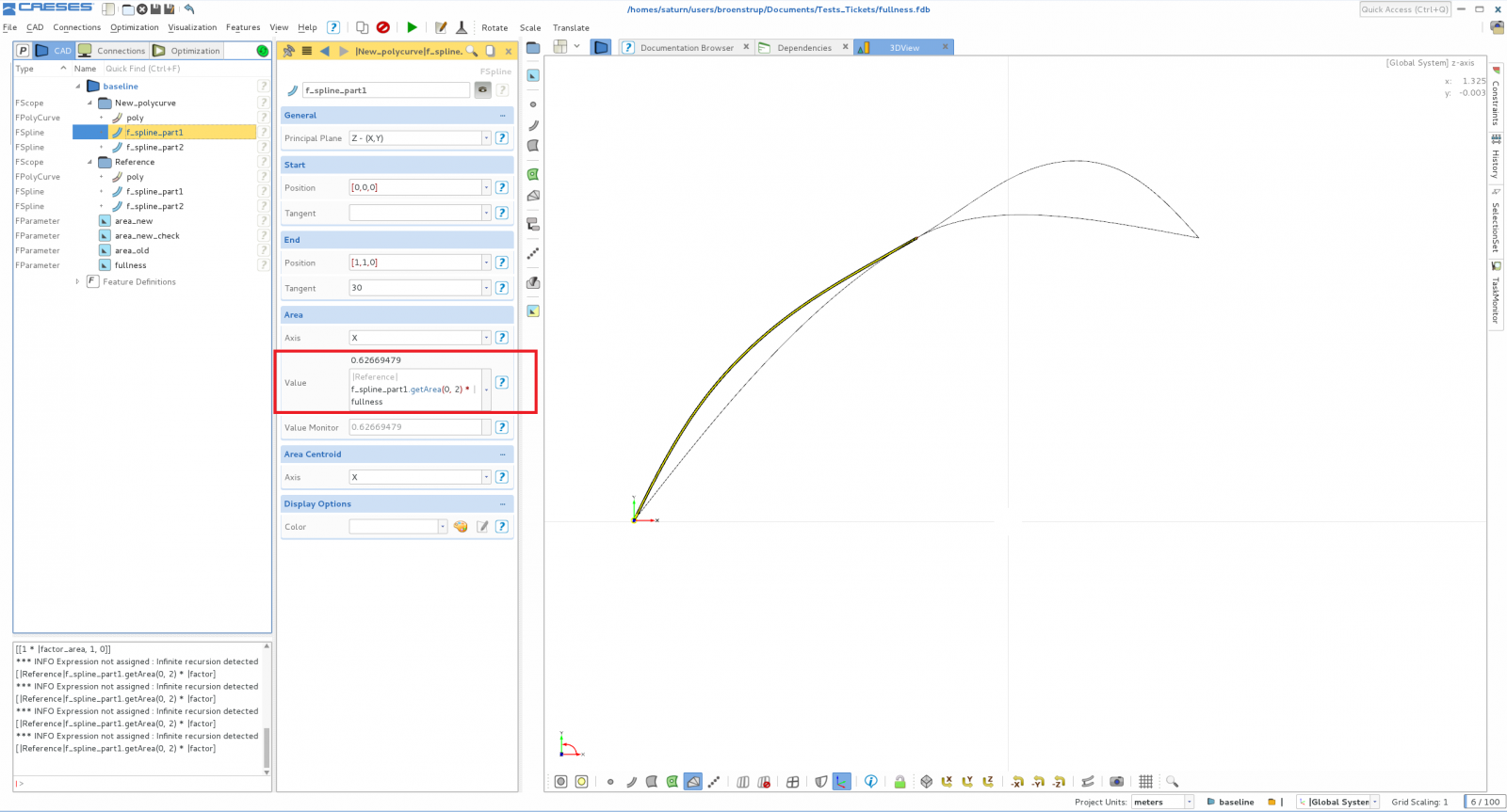

Hey,
I attached a screenshot on where to find the area of an f-spline.
Furthermore I made a little example, of how to change the area of the complete polycurve to a chosen value without changing the positions of the intermediate points:
  • There is a polycurve containing tow f-splines in the scope "Reference"
  • The parameter "area_old" is the area of the old or "Reference" polycurve
  • The parameter "area_new" can be chosen and the paramter "fullness" will be calculated, but it is alos possible to directly choose the value of "fullness"
  • The new f-splines/polycurves in the scope "New_polycurve" is calculating the new area value (see Screenshot "new_area")
I hope this will help you, otherwise it would be great if you could upload a screenshot of your problem/project.
Regards,
Simon
