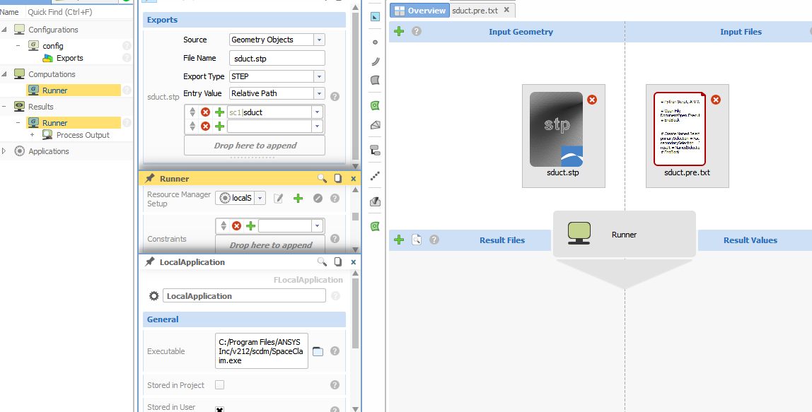

sajidrdo@gmail.com 0 Report post Posted July 10, 2024 Hi! I am trying to link caeses through space claim scripting, but when I am executing the .exe of space claim through caeses the file is not opening. The attachments are based on a sduct sample in tutorials sduct.pre.txt Share this post Link to post Share on other sites
Ceyhan Erdem 15 Report post Posted July 11, 2024 Hi Saji, I will recommend you go through the Caeses SoftwareConnector Tutorials. You are trying to run SpaceClaim however there is no mention of your script file. Maybe you would like to create a .bat file where the commands to run Spaceclaim (in with no gui maybe) using your script file. And then assigning that .bat file as your executable. Cheers Ceyhan Share this post Link to post Share on other sites
