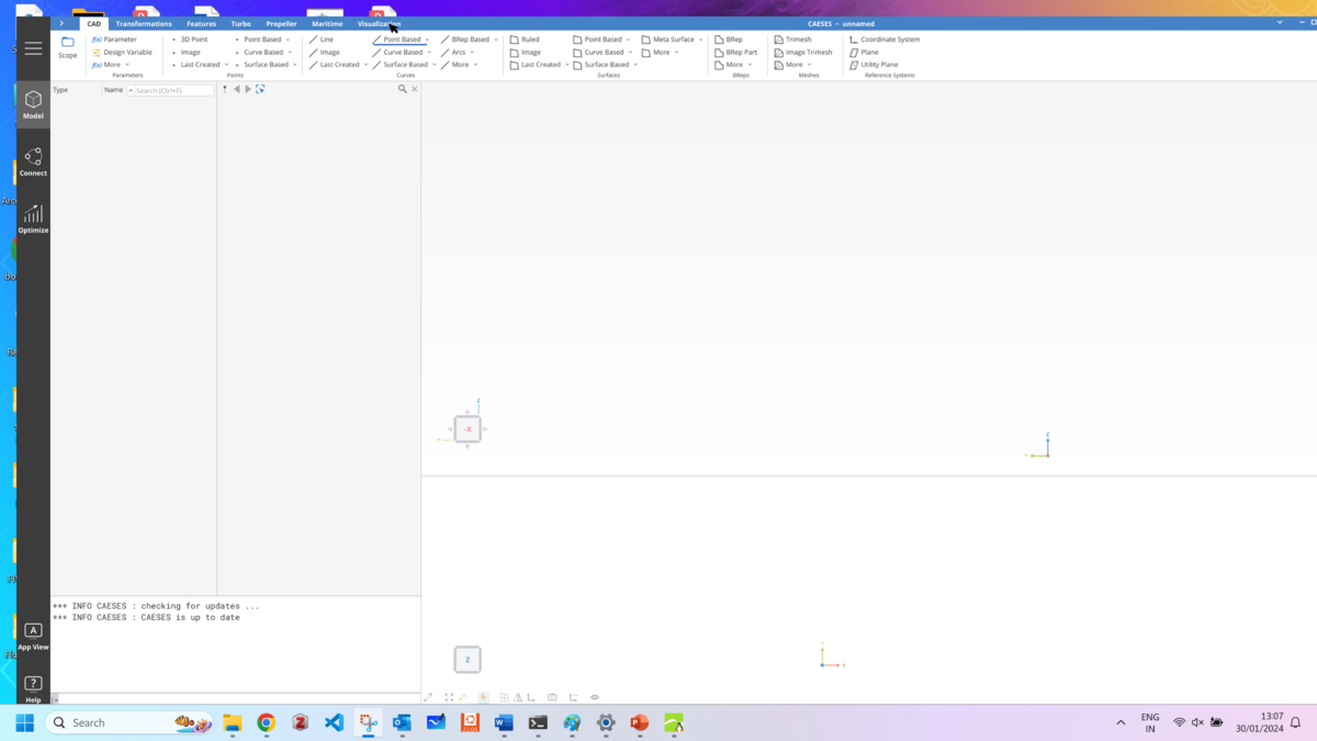

yuvraj 0 Report post Posted January 30 Hello Seb This didnt work for me but what worked for me is putting this line "export LD_PRELOAD=/usr/lib/x86_64-linux-gnu/libstdc++.so.6" line in ./Bashrc. Now CAESES is working fine.But window aligment is pretty messed up. I have tried majorly everything. I am running this in ubuntu 22.04(WSL2) I cant maximise the window, I am pointing cursor at one particular point and it is getting somewhere else. Please help regarding this. Regards Yuvraj Share this post Link to post Share on other sites
