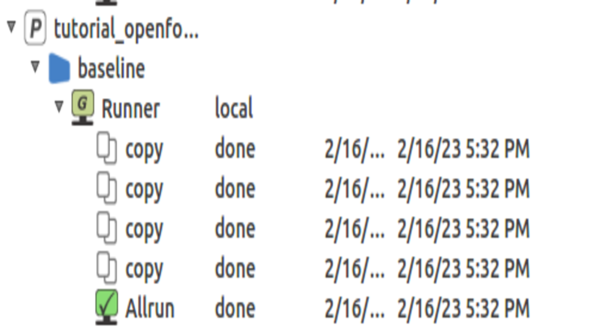

wh444 0 Report post Posted February 16, 2023 Hello, I am very new to CAESES. I am following the video tutorial: sduct CAESES as openFOAM GUI. I am working on Ubuntu 14 with CAESES 4 and OpenFOAM 6. The Issue is: openFOAM scripts runs successfully with the STL generated by CAESES trimesh without the connection. I try to connect OF6 with CAESES4, hit RUN and the taskMonitors looks like this. Then I found a new directory of files copied. The Allrun also seems to run which generates empty log files. I do not find any result file, in this case, folder named "500". This is the Allrun: blockMesh > blockLog surfaceFeatures -overwrite > surfaceLog snappyHexMesh > snappyLog simpleFoamShear > simpleLog #post processing postProcess -func 'patchAverage(name = sduct_lightpink,p) ' -latestTime >pin.dat case.foam *************************************************************************************************************** I was not able to upload the project file to the forum. But I am more than willing to provide it via other methods. I really appreciate any help! WX Share this post Link to post Share on other sites

wh444 0 Report post Posted February 22, 2023 Hi Hedi, thanks for the help. I tested the input files folder (generated by CAESES) and the error is that ./Allrun permission denied. After I gave the executable permission, it runs beautifully. Unfortunately, I did not find any post related to this issue on the forum. I tried run CAESES as admin (suggested in this post) but the same thing happened. I wonder if there is a way to give permission to the Allrun in CAESES. Thank you. Share this post Link to post Share on other sites
