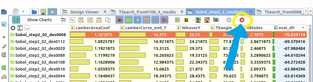

Mr. Mansur Zhussupbekov 0 Report post Posted June 23, 2022 Hi, When viewing the optimization results, there is an option to remove selected design from the table (the red X button on the attached image). When hovering the mouse pointer over that button, it says "Remove from table (not delete)". After having removed some designs, is it possible to restore them back to the table? Thank you, - Mansur Share this post Link to post Share on other sites
Mr. Heinrich von Zadow 5 Report post Posted June 24, 2022 Hi Mansur, yes, you can simply drag and drop designs into the table from the object tree on the left (as you can do with parameters and design variables as well). Also, since you screen shot gave it away -- I highly recommend you update to the latest release 5.0.1 😉 Cheers, Heinrich Share this post Link to post Share on other sites
