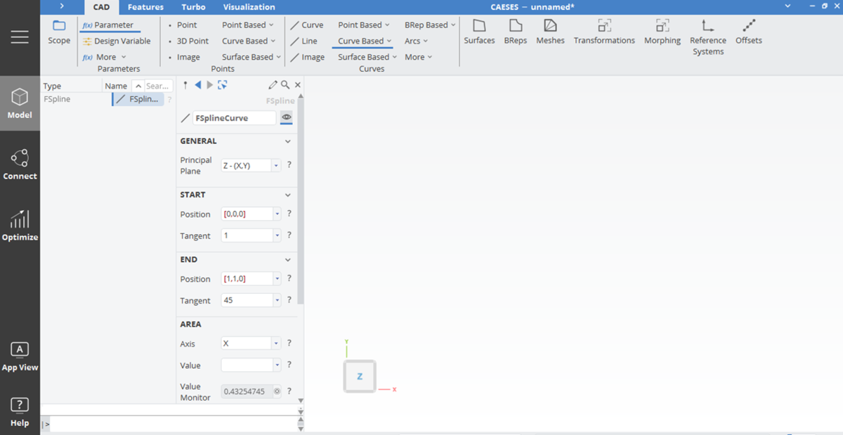

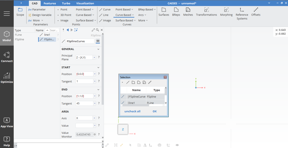

Javier 0 Report post Posted December 9, 2021 Good morning, I have a visualization issue with Caeses. The software opens and works normally, except that it is not possible to see any of the lines, or point nor models, even if I import them. At first, I though it was a simple setting detail although, until now nothing is working for me. I wonder if any of you have faced a similar problem and can share the solution. I am sharing some screenshots of what is happening, in case I did not make a clear explanation. Thanks you in advance, Best regards CJB Share this post Link to post Share on other sites

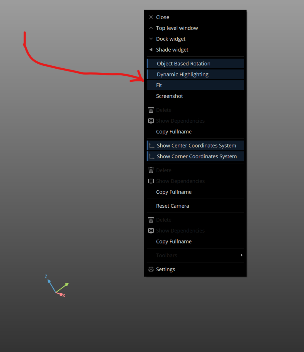

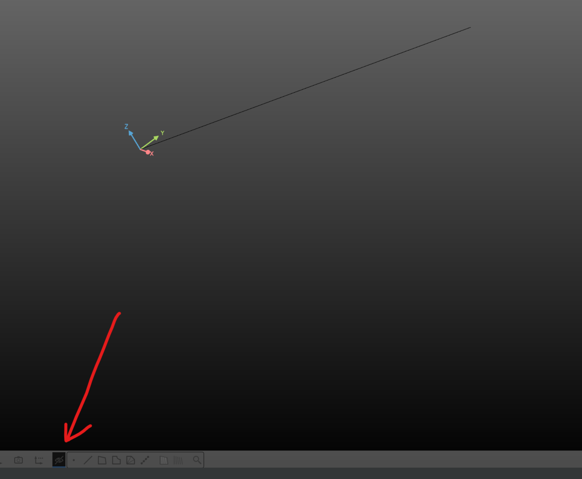

Mr. Bastian Ahlf 2 Report post Posted December 9, 2021 Hi, Have you toggled any of those filters? To fit your view, right mouse button and: Best wishes Bastian Share this post Link to post Share on other sites
