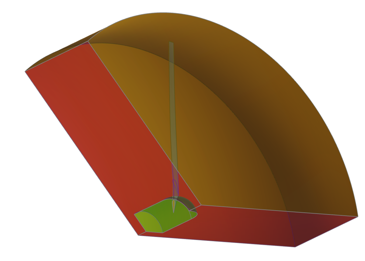

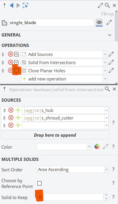

Mr. Heinrich von Zadow 12 Report post Posted November 4, 2021 Hi Armagan, I took a look at the project. From what I could see, the solid blade was not generated correctly. I adjusted a few settings as follows: From there it looks as as if everything works well and you get the correct flow domain: Cheers, Heinrich WindTurbineAE.cdbc Share this post Link to post Share on other sites
