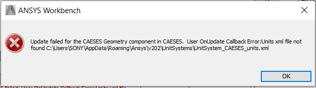

Armagan 0 Report post Posted September 23, 2021 Hello, I hope you are doing well. I would like to ask question about failure which is indicated as importing .fsc file to Ansys Workbench to run in Batch Mode. Warning is shown in the attachment with my fsc file. Could you please help me to solve the problem? Best Regards windturbine.fsc Share this post Link to post Share on other sites
Ceyhan Erdem 15 Report post Posted September 23, 2021 Hi Armagan, Can you please let me know which ANSYS version you are using? I suspect the version you are intending to use is not compatible with the current ACT version. Cheers Ceyhan Share this post Link to post Share on other sites
Armagan 0 Report post Posted September 23, 2021 Hello Ceyhan, Thank you for your quick reply. I am using Ansys 2020 R2. Best Regards Share this post Link to post Share on other sites
Ceyhan Erdem 15 Report post Posted September 24, 2021 Hi Armagan, This is interesting. Normally you shouldn't have had any problems. Can you please delete the 3rd line in the fsc file and give a try again? "// Project Units millimeters" Meanwhile I will be looking into the code to figure out the issue. Cheers Ceyhan Share this post Link to post Share on other sites

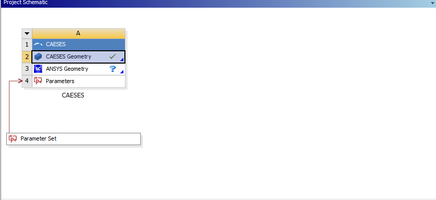

Armagan 0 Report post Posted September 27, 2021 Hello Ceyhan, Removing third line worked. But Ansys Geometry cannot seem on the Ansys Workbench as shown below.. Could you please inform me about reason and solution. Best Regards Armagan Share this post Link to post Share on other sites
Ceyhan Erdem 15 Report post Posted September 27, 2021 Hi Armagan, This is strange. I will suggest to have a web-meeting to recreate the issue. Please email to erdem@friendship-systems when you may be available on the next days. I will try to fit my schedule. Cheers Ceyhan Share this post Link to post Share on other sites
Ceyhan Erdem 15 Report post Posted October 27, 2021 Here is the fix for the "Units xml file not found" problem if anyone encounters; Seems like there is a certain bug in Ansys only observed on certain machines after installing a new ANSYS version; Please go to the folder; C:\Users\ <user name> \AppData\Roaming\Ansys\ <ANSYS version> \UnitSystems in my case the ANSYS version was v212 There you have to modify the file Ans.Units.config Please search for the entry; <UnitSystem Name="CAESES_units" DisplayName="CAESES units" BaseUnitSystem="SI" FileNamePath="C:\Users\erdem\AppData\Roaming\Ansys\v212\UnitSystems\UnitSystem_CAESES_units.xml" IsSuppressed="false" /> and delete it. Afterwards please save the file. You have to perform this once. Due to a bug this issue is creating a problem, when a new ANSYS version is installed. Afterwards CAESES_Workbench_App should be working just fine Share this post Link to post Share on other sites
