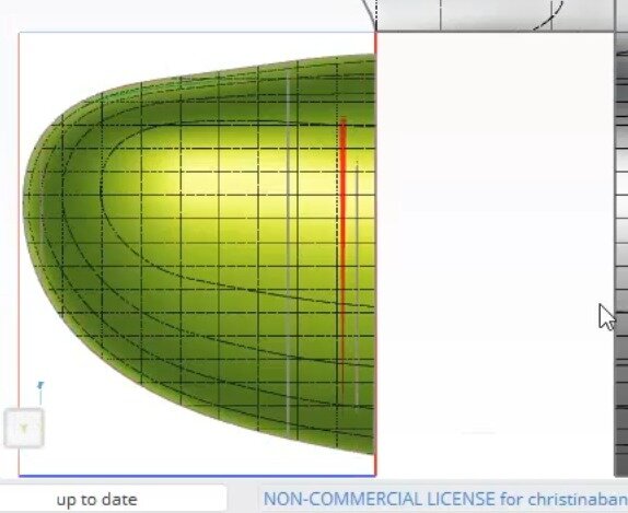

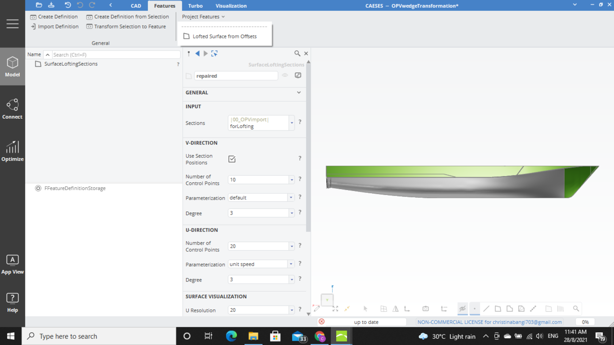

Christina 0 Report post Posted August 28, 2021 Greetings. To whom it may concern. I am currently doing a project that involve the lofting feature. I have been discovering several samples and tutorials for ship lofting. As per attached, I found a project feature that is not available on my caeses. The feature is named Lofted Surface from Offsets. My question is, is there any tutorial for me to create this feature or better yet, to apply this available feature to another project file? Thank you in advance. Share this post Link to post Share on other sites
Mr. Claus Abt 11 Report post Posted August 30, 2021 HI Christina, you can copy the feature definition into your feature directory or define a new location in "custom features, set custom locations". Alternatively you can edit the feature if you double click on the feature or click on the edit-icon next to the name "repair" and then export the feature definition in the "general" tab to any directory that you then include in your custom locations. Best regards Claus SurfaceLoftingSections.fdf Share this post Link to post Share on other sites

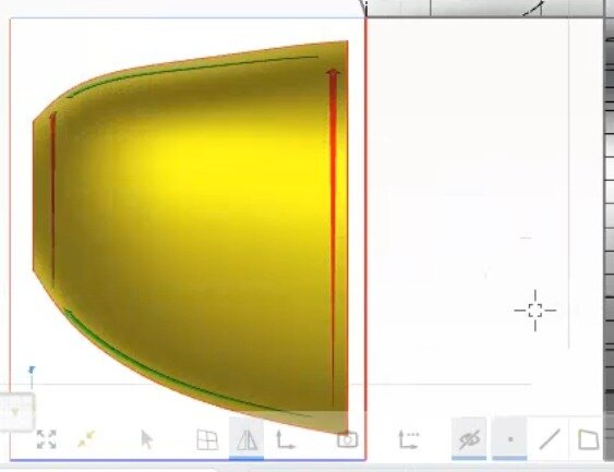

Christina 0 Report post Posted September 8, 2021 Appreciate it a lot Mr. Claus. If i may ask you another question, why did my lofting does not apply to the entire surface. Instead, it looked more like the attachments shown. I have been using the Surface Lofting Sections feature for this part, but I did not get the result as I have seen from the example I got. May I know what is the issue? Share this post Link to post Share on other sites
