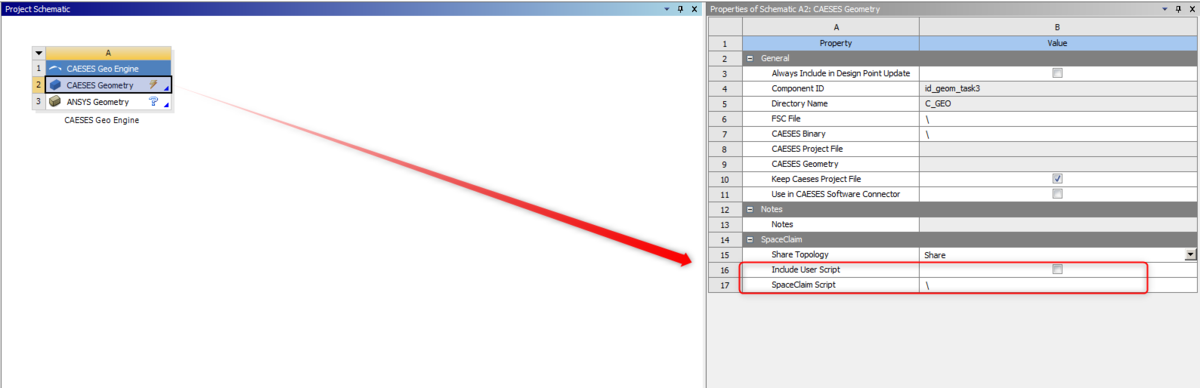

Ceyhan Erdem 15 Report post Posted May 18, 2021 Hi Armagan, In contrary to DesignModeler, while using the current version of CAESES Workbench App, it is not possible to keep the record of the user performed actions in SpaceClaim. However I can suggest two workarounds. Either you can use DesignModeler or you can create your own SpaceClaim script and provide it to CAESES Geo Engine. Please check the attached picture. Please be sure that you are using the latest version of CAESES Workbench App that is included inside CAESES binary. <CAESES5 installation Dir>/etc/ansys/ Please let me know this resolves your problem. Cheers Ceyhan Share this post Link to post Share on other sites
