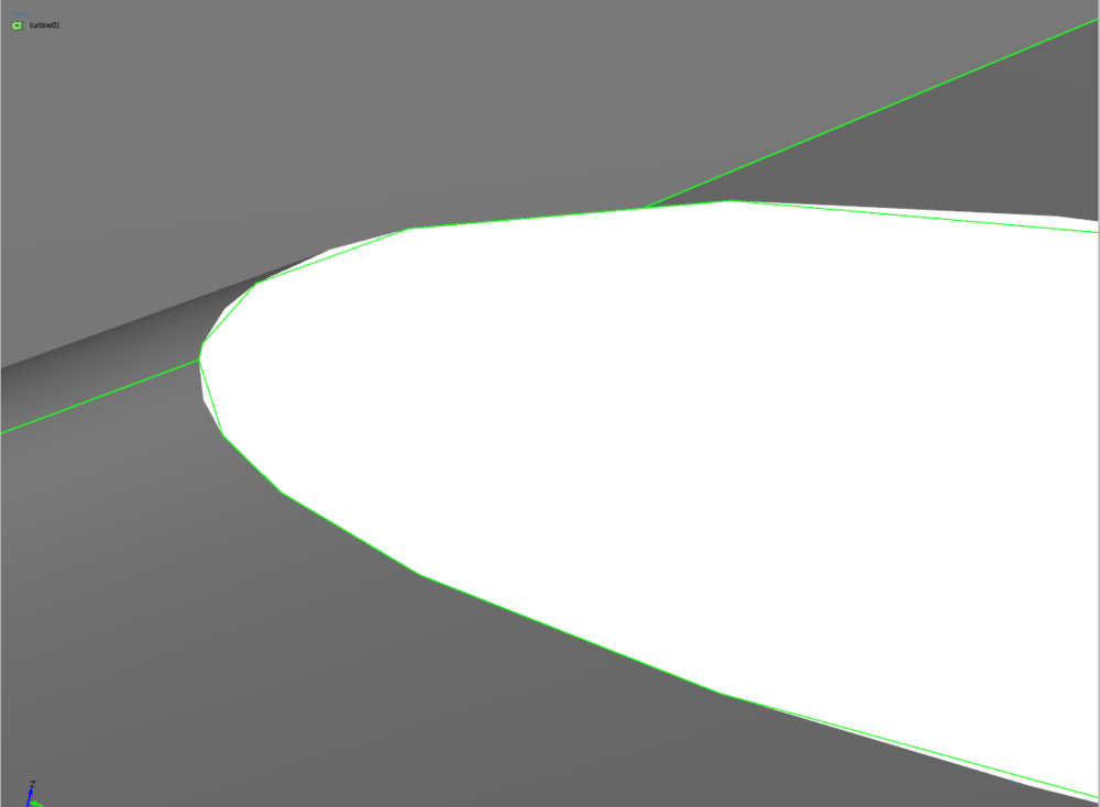

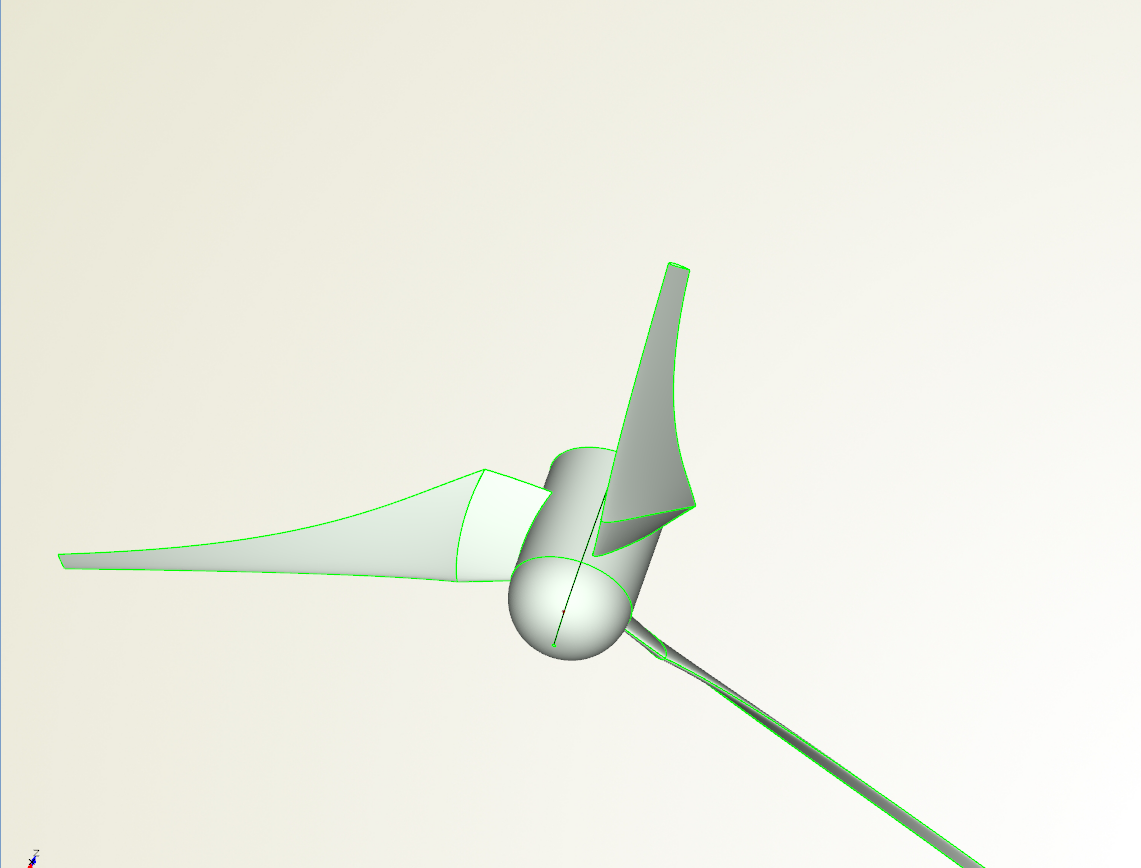

Armagan 0 Report post Posted October 26, 2020 Hello, I would like to ask quetion about resolution. I have wind turbine gometry on Caeses. But, tip of my blade seema angled as shown photo in the attachment. Could you please tell me how I can fix it. Thank you in advance Share this post Link to post Share on other sites

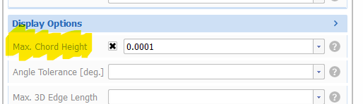

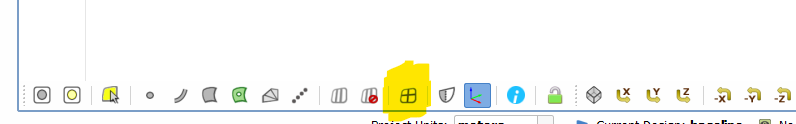

Mr. Heinrich von Zadow 12 Report post Posted October 26, 2020 Hello Armagan, from what I can see, this is just a rendering issue -- the geometry might be perfectly smooth. If you toggle wireframe view, you will see the underlying triangulation. However, unless you a planning on exporting tesselated data (i.e. STL) this is probably nothing to worry about. If you still want finer triangulation, you can change i.e. the maximum chord height of your BRep: Cheers, Heinrich Share this post Link to post Share on other sites
