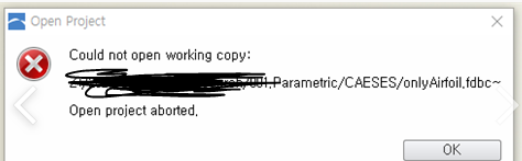

Mr. lee down 0 Report post Posted September 21, 2020 when I try to open project, following error occurs : All CAESES projects in my computer and my colleague's have the same problem what should I do for this problem? Share this post Link to post Share on other sites
Mr. Claus Abt 14 Report post Posted November 11, 2020 You can rename the project, take away the ~ and make sure the project is not opened by another instance of CAESES. Best regards Claus Share this post Link to post Share on other sites
