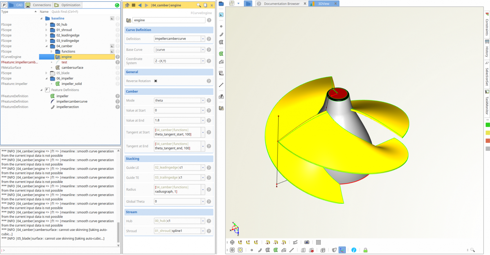

    I've been modeling a jet ski impeller based on this tutorial https://www.caeses.com/blog/2015/video-blade-design-tutorial/ and I already got something like its shown in Picture 1.

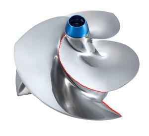

    Nevertheless, on the last step, I came across the following problem. In the original impeller (Picture 2), the value for Theta varies along the Leading edge from 0 to a certain angle (e.g 45º), as the theta value along the Trailing edge remains constant, generating a straight line (marked in red Picture 2). I attempted to achieve the same result expressing the value of general Theta through a fspline which varies from 0º to 45º throughout the x-axis. However, I got something as I already expected, which is shown in Picture 3, where the theta value varies from 0º to 45º throughout the x-axis but along the whole surface.
    What options do I have in order to apply this change to the Leading Edge but keeping the theta value for the Trailing Edge constant creating a straight line, achieving a impeller like shown in Picture 2 ??
