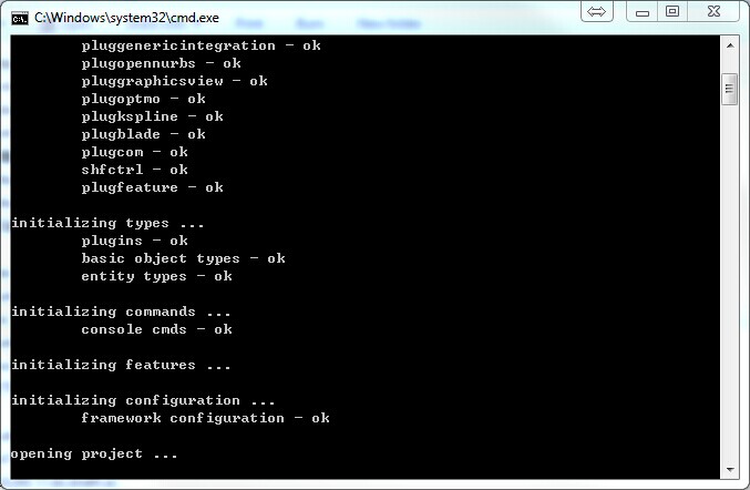

Dear Joerg,
Thank you very much for your reply!
I had those export and closing information at the end. Because the input information is long so I didn't show this part in last example. If I run the batch file manually, I don't have any problem in getting the new hullform. The problem is when I link the .fsc file to VBA, batch file stopped before opening the project in CAESES.
I am eager to link the batch file to ModeFrontier, do you know any other way to do this?
Thanks a lot for the help in advance!
Hi CAESES Team,
I was trying to use CAESES software as a hullform generator.The parametric model has been generated already. The next step is to link the CAESES with another optimisation software ModeFrontier through Visual Basic Application in Excel.
This is the reference I used:
https://www.caeses.com/forum/index.php?/topic/284-batch-mode/%3fview=getnewpost
In VBA, "Shell" function is used to run the batch file. But the process stopped before the batch file trying to open CAESES software (I put all the files in a same folder already).
Image 1: run batch file manually
Image 2: run batch file through VBA (stopped with this status)
Image 3: .bat
Image 4: input (.fsc)
I am wondering, is there any special reference or setting I should add in controlling CAESES automation?
I got stuck in this problem for a few days. Could someone help me to solve this problem? Thank you very much!
