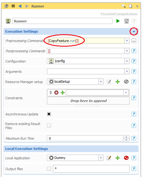

Hi again,
I think the problem is, that when doing the runs you didn't import a ".csv" file as you can see in your software connector. If you deleted the results automaticly after a run I fear you cant recover them. But if you have the ".csv" files still somewhere you can read them into CAESES through a little trick. That requiers you to run the Sobol again with a dummy as executable (e.g.) Editor or Notepad. Then you can write a feature, that copys the result files from where they are right now to the location of the new "dummy" Sobol (this time the .csv needs to be in the software connector under result values too). This should solve the Problem.
The feature definition would look something like this:
cp(<directory/>+getCurrentDesign().getName()+"/OldSobolName or Directory with the csv", getDesignDir()+"/NewSobolComputationName")
Then create the feature and select it to run infront of the Computation (See Screenshot)
Greetings
Willy

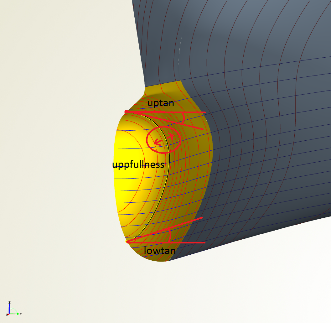

Hey Shahriar,
so what happens to create the bow you sweep an fspline along the profile lines.
The upper and tan discribes the angle the bow will have at top and the lower tan will do the same for the bottom part of the bow.
The fullness is influencing the volume the bow will have at the top part.
I tried to put all this into the picture attached.
Hope this helps you
Greetings

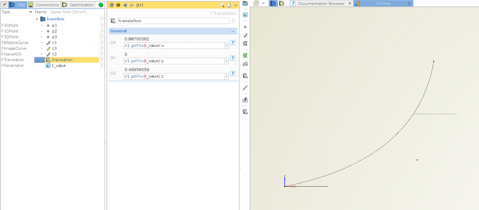

Hey Brami,
to solve this problem you can use a translation instead of a sweep transformation. The key is to use the .getpos() command onto the curve. If you have a setup like in the picture it should work just fine.
As an input for the getpos() i used a parameter that goes from 0 to 1.
Hope this is what you needed, if not feel free to ask again.
