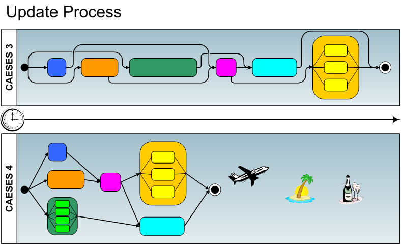

The following picture (which was also shown at last year's User's Meeting in Berlin) tries to illustrate the difference:
So, what we can see is, in the current version (up top in the picture) objects are updated serially - ordered by their dependency. Some objects already make use of the multiple cores the CPU provides, as they calculate some stuff in parallel (the last box), but that is rare. NgCAESES (bottom - labeled as CAESES 4, but I, personally, don't want to throw any version numbers around) builds a graph of dependent objects, and different branches of that graph are then updated in parallel. Additionally, a lot more objects have their internal algorithms parallized. This - as you can clearly see in the picture - leaves you - the engineer - a lot more time to travel, relax, and party ;)

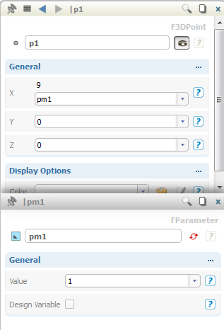

As stated, that example is harmless, but there are several not so harmless cases, that lead to undesired behavior. One more example:
Let's assume you have a point p1. Let's further assume you have a parameter pm1 that defines the x-coordinate of that point. Now, for whatever reason, the user enters the command "p1:x = 9" in the console which is supposed to set the x-coordinate to the value 9. Well... it does set the x-coordinate to the value 9 (i.e. the point will actually be there), but it will leave you with the following undesired state:
So what do we have here? The parameter pm1 has the value 1, the x-coordinate of the point is still set to be said parameter, but the actual value is 9?! That can't be right! So what happened? Well, without going into too much detail: p1:x returns a FDouble, which is then assigned to using the '=' operator. Nothing bad about that.
BUT! p1:x does not really have a double as a value, but an FParameter. That FParameter is (automagically) converted into an FDouble (while the conversion is pretty straight forward in this case, it's still neccessary). So the p1:x actually returns a temporary FDouble that is the result of the conversion of the parameter pm1 to a (temporary) FDouble.
And now, the operator '=' assigns the new value '9' to exactly that temporary FDouble. In turn, this means that the wrong state is resolved after changing the parameter (because the temporary FDouble will be replaced by a new temporary FDouble) or after re-opening the project, but it's still bad that this state can occur.
Ok, to be honest, I probably lost most of my readers (if you even got this far) with that last paragraph... Read it again... It might just make sense eventually...
