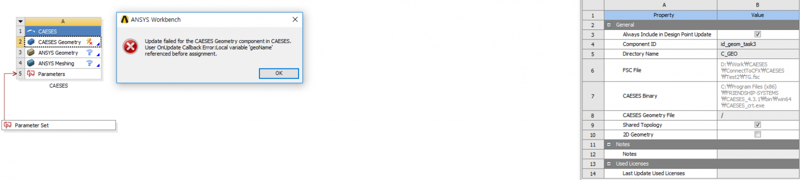

Mr. Kim Moo Sung 0 Report post Posted June 1, 2018 Hi~ i want using script for running with ANSYS app. in TurboGrid, i can import curve file using the "Feature Definitions” in CAESES. but i can`t update fsc file in ANSYS Workbench What can i do...? I put below contents in fsc|Blade.run()|Hub.run()|Shroud.run() thanks best regardsMoo SungAxialfan_TG.zip Share this post Link to post Share on other sites

Mr. Kim Moo Sung 0 Report post Posted June 7, 2018 Hi Ceyhan, What i did is Connecting TurboGrid in Workbench. In Workbench, CAESES ACT app is used to couple CAESES and ANSYS. So, I imported FSC File(I attached in 1st poster) in Workbench. and updated CAESES ACT app. But it can`t work. Maybe i think It can`t just use CAESES ACT app with FSC file. thanks. best regards Moo Sung Share this post Link to post Share on other sites
Ceyhan Erdem 15 Report post Posted June 7, 2018 Hi Kim, I see. For the time being the CAESES ACT App for ANSYS Workbench does not support Turbogrid. But we are working on it and soon I guess we will have the ACT App supporting it. CheersCeyhan Share this post Link to post Share on other sites
