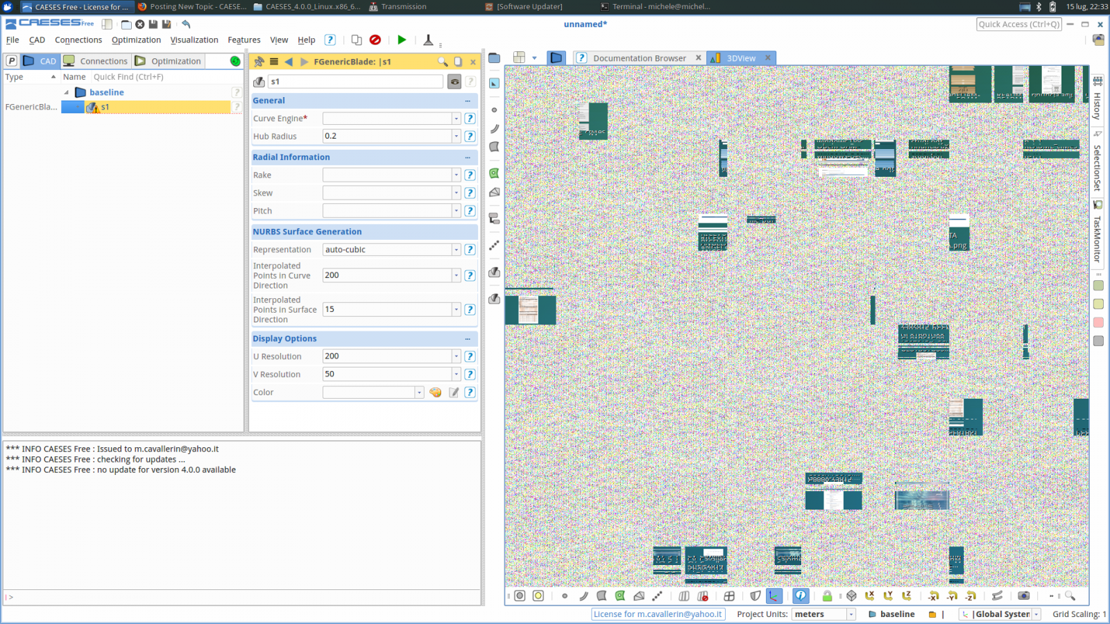

Mr. Michele Cavallerin 0 Report post Posted July 15, 2015 Hi all, when I run Caeses 4.0.0 on my Ubuntu 14.04 I can't see the 3D viewer. On the terminal I have the following messages loading plugin libraries ... isisctrl - ok plugbase - ok plugmeta - ok plugopt - ok plugxffl - ok pluggenericintegration - ok plugopennurbs - ok plugnax - ok pluggraphicsview - ok plugoptmo - ok plugblade - ok plugfeature - ok initializing types ... plugins - ok basic object types - ok entity types - ok view typeslibGL error: unable to load driver: nouveau_dri.so libGL error: driver pointer missing libGL error: failed to load driver: nouveau libGL error: unable to load driver: swrast_dri.so libGL error: failed to load driver: swrast - ok initializing commands ... all - ok initializing features ... initializing configuration ... framework configuration - ok updating geometry - ok (CAESES:14733): Gtk-CRITICAL **: IA__gtk_widget_get_direction: assertion 'GTK_IS_WIDGET (widget)' failed (CAESES:14733): Gtk-CRITICAL **: IA__gtk_widget_get_direction: assertion 'GTK_IS_WIDGET (widget)' failed Attached there's a screenshot, but I can0t manage to solve this problem alone, can you please help? thanks a lot Regards. Share this post Link to post Share on other sites
Mr. Konrad Lorentz 2 Report post Posted July 16, 2015 Dear Michele, please install a propreritary nvidia driver. This should fix your problem. without checking the solution, I found a tutorial:https://help.ubuntu.com/community/BinaryDriverHowto/Nvidiahttp://www.binarytides.com/install-nvidia-drivers-ubuntu-14-04/ Please report your solution. RegardsKonrad Share this post Link to post Share on other sites
Mr. Konrad Lorentz 2 Report post Posted July 16, 2015 Or try this: cd /opt/CAESES_4.0.1.snap_20150715_Linux.x86_64/lib/Linux.x86_64/mv libstdc++.so* missing_libs/cd ../.../CAESES 1 Share this post Link to post Share on other sites
Mr. Konrad Lorentz 2 Report post Posted July 16, 2015 I heard by a CAESES Free user: "moving the libs to the missing libs dir did the trick *without* playing with nvidia installs :))..." RegardsKonrad Share this post Link to post Share on other sites
Mr. Michele Cavallerin 0 Report post Posted July 17, 2015 Hi Konrad, thank you very much. For me it worked by installing Nvidia propetary drivers! Thanks Cheers Share this post Link to post Share on other sites
