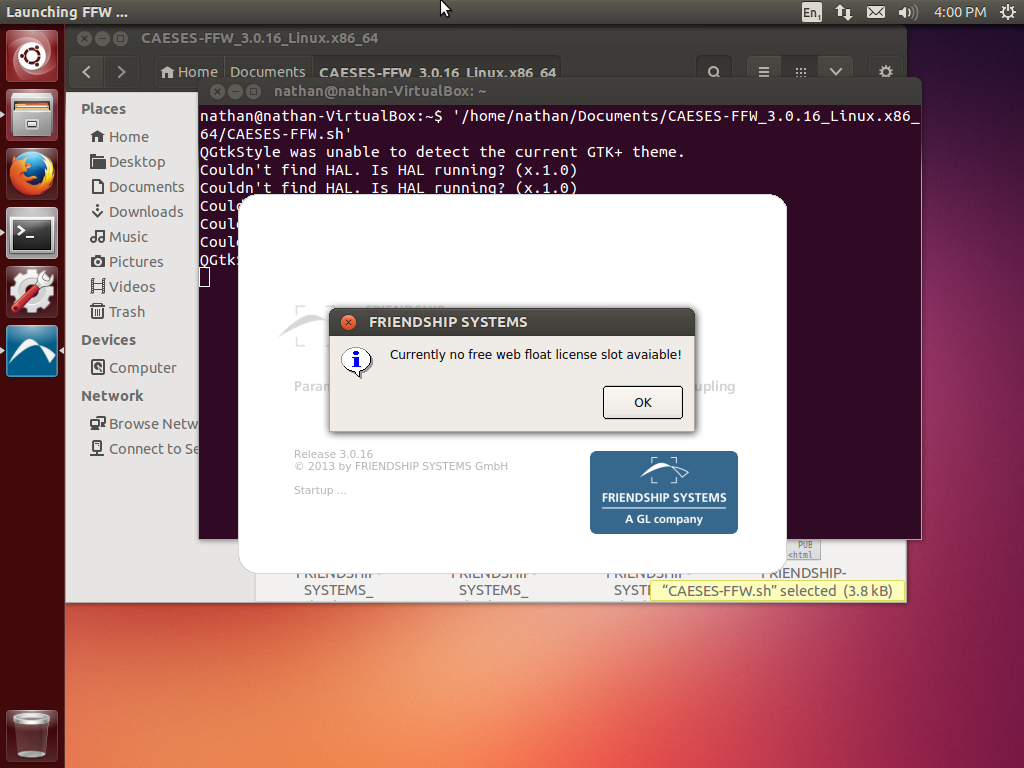

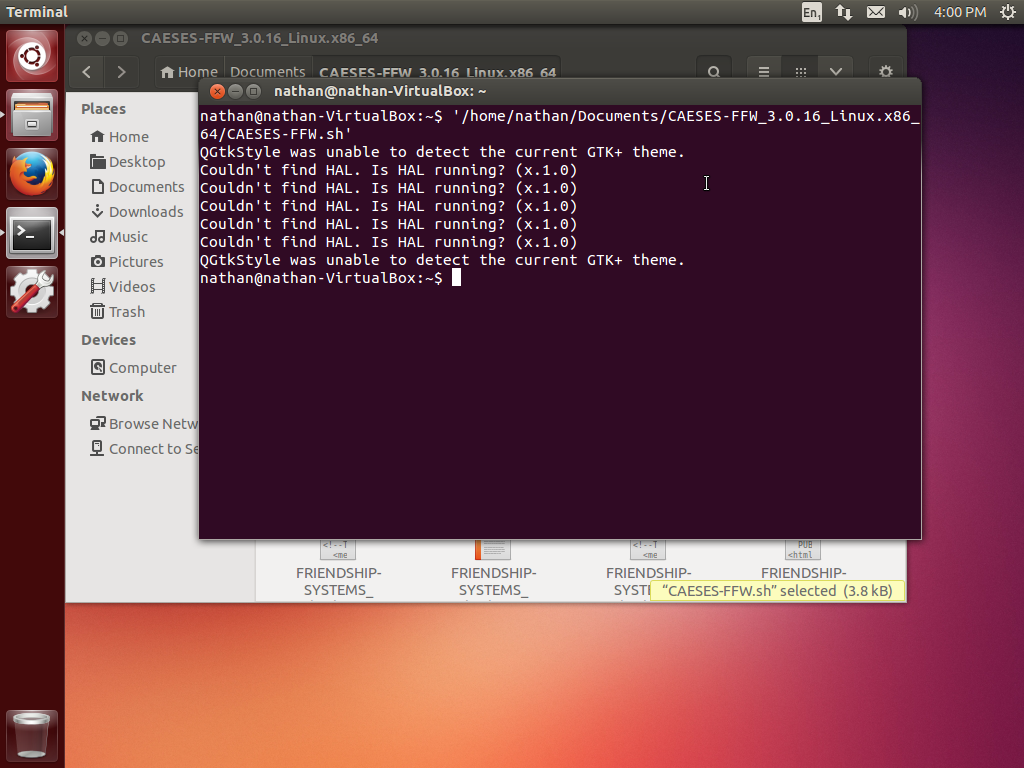

Mr. Nathan Alexander 0 Report post Posted January 11, 2014 As the 64-bit Linux installer is running: After (seemingly) successfully filling in my account info: I am running Ubunto 64-bit on a Mac via VirtualBoxVM. Share this post Link to post Share on other sites

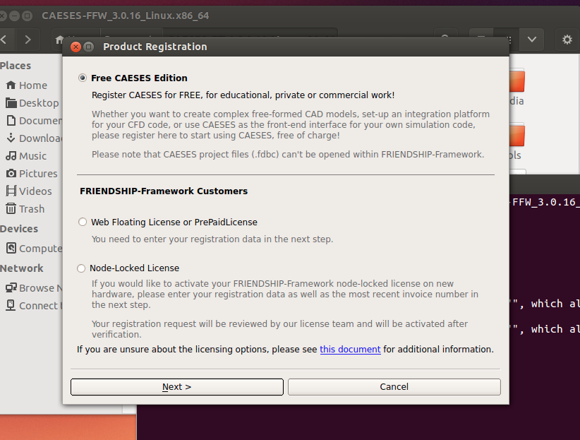

Mr. Konrad Lorentz 2 Report post Posted January 11, 2014 Please start Caeses with this additional argument: -resetauth one time. Do not select WebFloatLicense, take the First one: CEASES. RegardsKonrad Share this post Link to post Share on other sites
Mr. Nathan Alexander 0 Report post Posted January 11, 2014 Hi Konrad. Thanks for your help. I selected the first option, "CAESES," originally. Nevertheless, I ran the program again with the "-resetauth" argument and once again selected "CAESES." I still got the error message. Share this post Link to post Share on other sites

Mr. Konrad Lorentz 2 Report post Posted January 14, 2014 Hi Nathan, I think you didn't registered for CAESES, yet. Did you selected the first option in the registration dialog? RegardsKonrad Share this post Link to post Share on other sites
Mr. Nathan Alexander 0 Report post Posted January 14, 2014 EDIT - more current log attached. I did indeed select the first option.startuplog.html.zip Share this post Link to post Share on other sites
