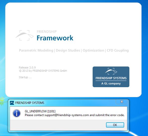

Mr. Roy Powell 0 Report post Posted August 6, 2013 Could someone please help with the following issue? After Installing the downloaded 32-bit file and starting the application, this error message is displayed: GL_UNDERFLOW [1101] The startup-process is then halted and the application does not work. No error messages were received during installation. I am running windows 7. Thanks Share this post Link to post Share on other sites
Mr. Arne Bergmann 27 Report post Posted August 6, 2013 Dear Roy Powell,Could you please check the time settings of your computer? This problem usually occurs if the local time is set up incorrectly.Best regards Share this post Link to post Share on other sites
Mr. Konrad Lorentz 2 Report post Posted August 6, 2013 If you installed it on a Network Share, please setup/Sync the times between both. Share this post Link to post Share on other sites
Mr. Roy Powell 0 Report post Posted August 6, 2013 Thank you Konrad and Anne for your replies. I did check the time settings on my laptop and corrected them to match my time-zone. After doing this, the application did start up and run. I was able to shut down the application and start it again too. However, right now the same error message appears and the application fails to run. The install is on a stand-alone laptop without network connectivity. Could you please help me out again? Thanks,Roy Share this post Link to post Share on other sites
Mr. Arne Bergmann 27 Report post Posted August 6, 2013 Could you please send the startup logfile from a failed attempt to start the software. Please see this forum post for how to find it: http://www.friendship-systems.com/forum/index.php?/topic/28-how-do-i-handle-error-messages-when-starting-the-framework-or-caeses/ Note that you will need to zip the html file since the forum does not allow html files as direct attachments. Share this post Link to post Share on other sites
Mr. Roy Powell 0 Report post Posted August 7, 2013 Dear Arne, Please find startup log in your email at a.bergmann@friendship-systems.com. Thank you for your help. Kind regards,Roy Share this post Link to post Share on other sites
Mr. Arne Bergmann 27 Report post Posted August 7, 2013 Dear Roy, There still seems to be a problem with your time settings. The last entries in your logfile have a timestamp that is in the future (Aug 7th, 12 pm) - you are located in the Netherlands, right? Please verify again, that your time settings are correct. Some initialization routines of CAESES are dependent on a correct setting. Best regardsArne Share this post Link to post Share on other sites
Mr. Arne Bergmann 27 Report post Posted August 7, 2013 Hi Roy, Please delete all files (and directories) in %APPDATA%/friendship/ and start the software again. Best regardsArne Share this post Link to post Share on other sites
Mr. Roy Powell 0 Report post Posted August 7, 2013 Dear Arne, Thank you for your help. After deleting all files and folders in the appdata/friendship/ folder, the application ran perfectly. My current time-zonen is singapore so not The Netherlands. However I am from The Netherlands. The download and installation of your software was done on my laptop in Singapore time zone. Again thank you for your help. Kind regards,Roy Share this post Link to post Share on other sites
