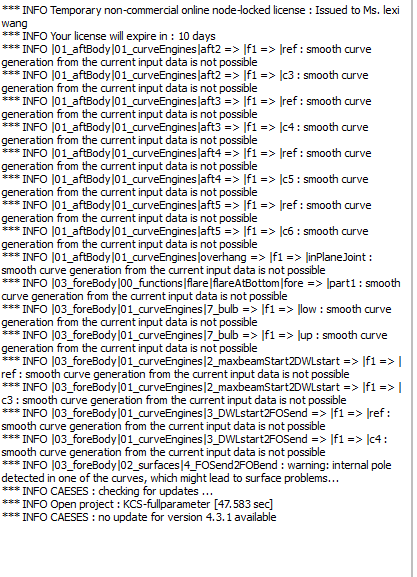

3.Recently when I open the files i have got some tips on the model like in figure. question ,
How can I repair them?

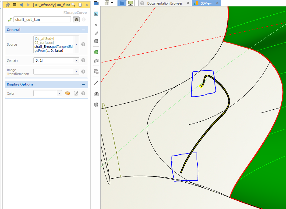

4.When I am trying to get the shaft_cut_tan in the figure.question2. I cannot make the
start and end point for Y=0, that is why i cannot close the shaft totally. How can I repair this
problem?
