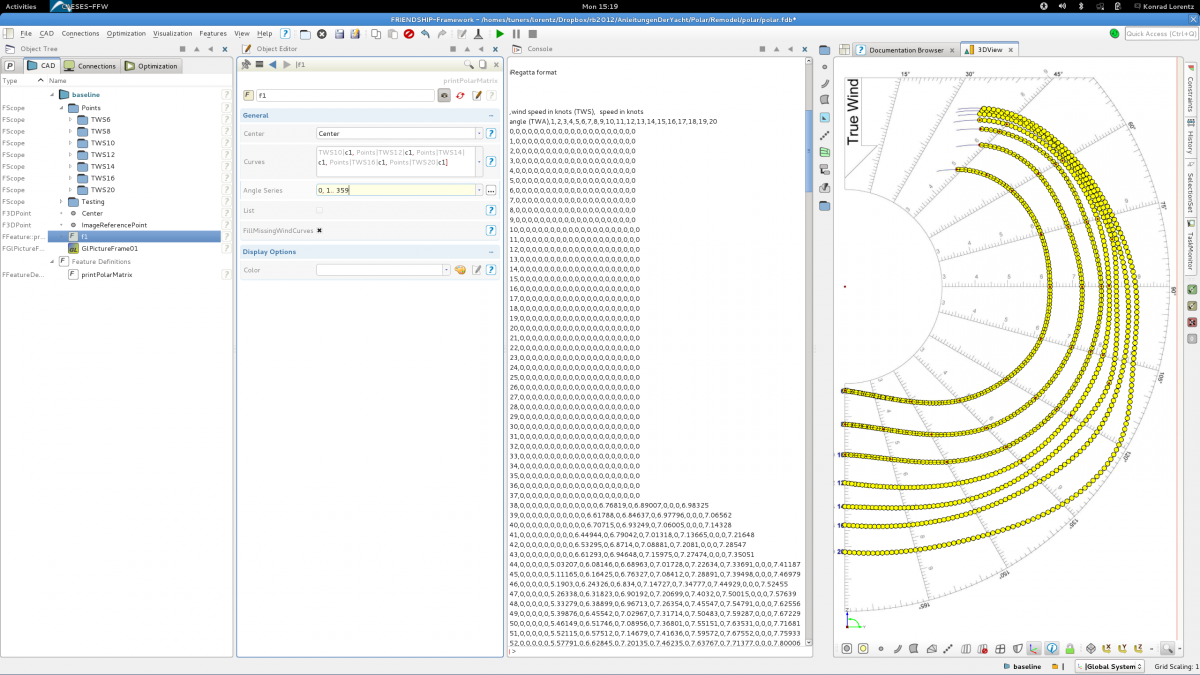

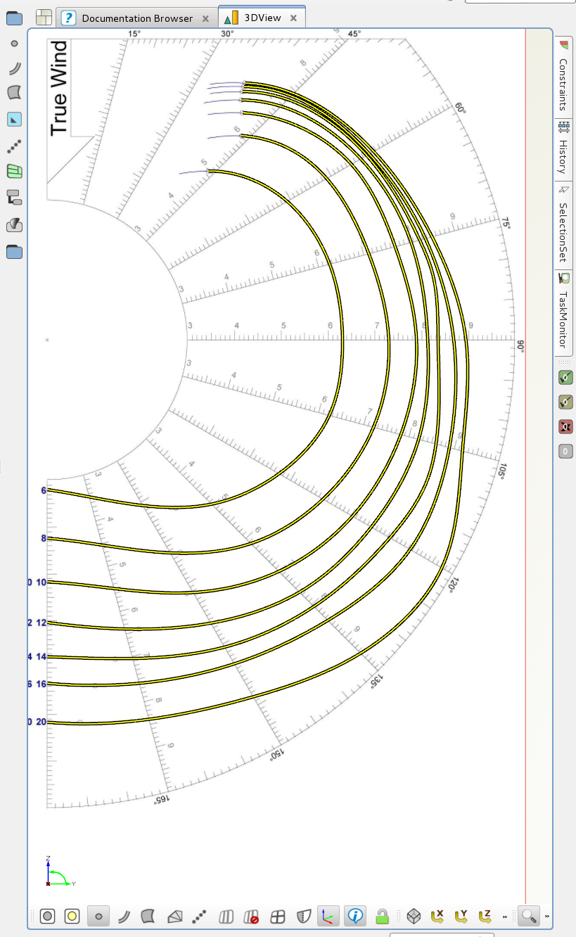

I decided to remodel my curves in the FRIENDSHIP-Framework (CAESES will also work) using interpolation curves.
I created a GLPictureframe. loaded the polar plot image found in the web as png.

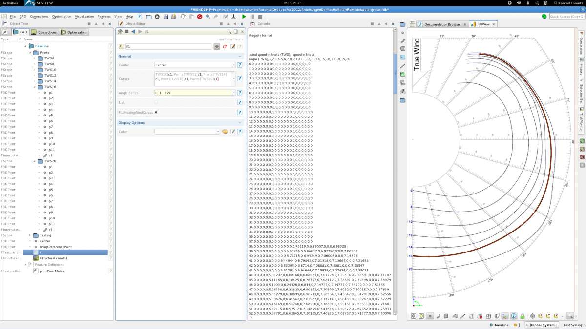

I switched to the grid view and added some points on the curve (windspeed curve).
Put them into a scope, used these points to create an interpolation curve.
The curves are there!

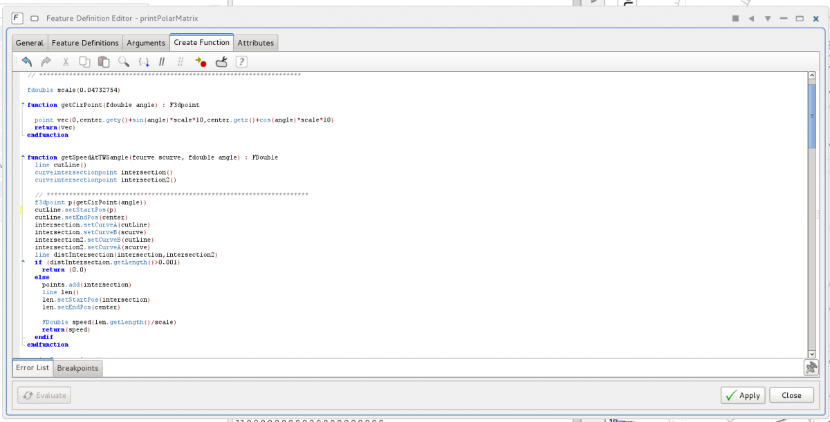

The next step is to define a functionality to get the boat speed using the TWA (TrueWindAngle) and the TWS (TrueWindSpeed).
Now I created a loop around it, to call the function with different curves (windspeeds) and different attack angles.
"Playing" around: (press the Run button on the feature)
Next step: Put the console output into a text file, load it in your app and have fun.
