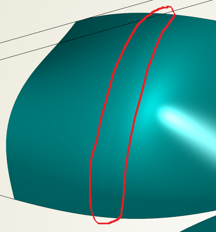

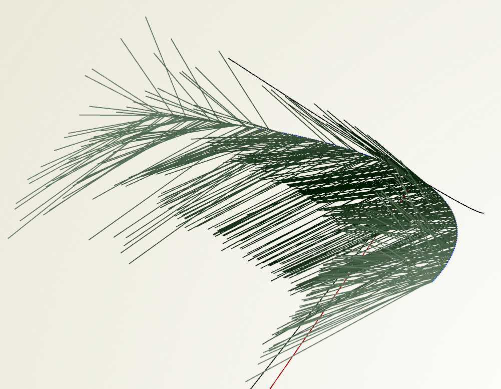

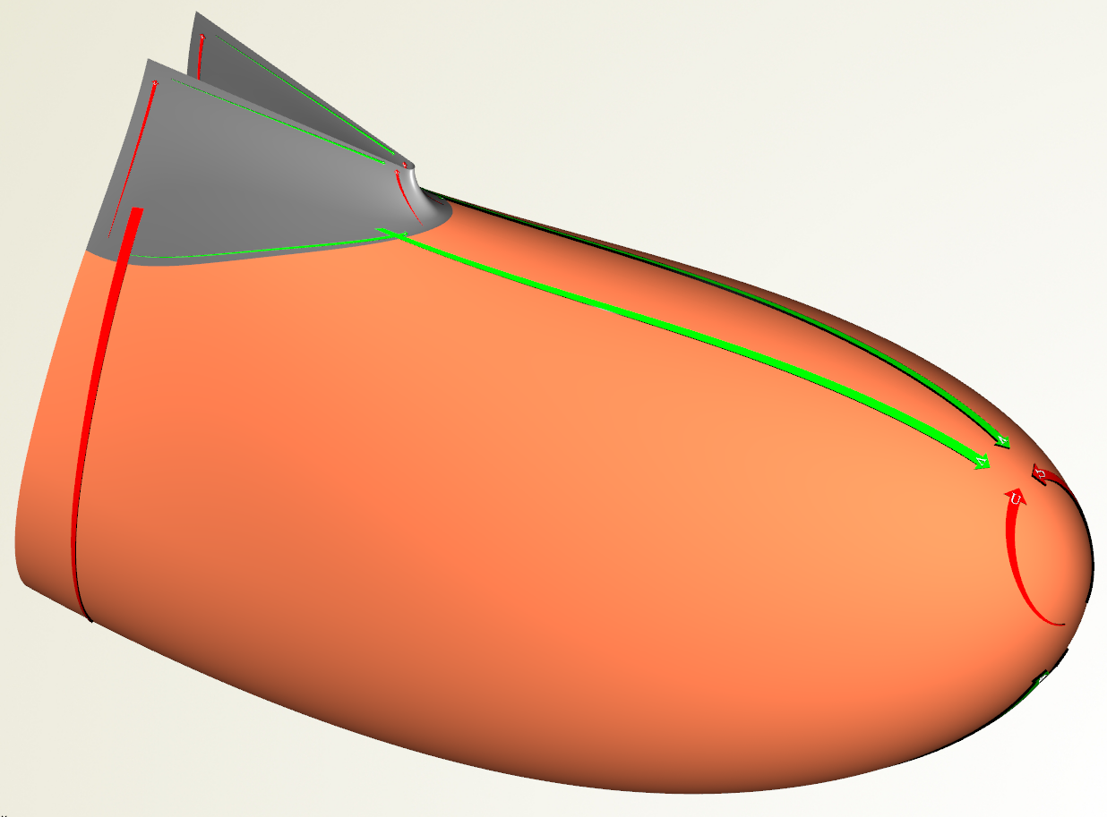

// image 5 - UV orientation (in my case). Otherwise vt1u, vt1v are reversed and can change direction (+ to -)
vector vt1((vt1u * (1 - blend) - vt1v * blend).getNormalized())

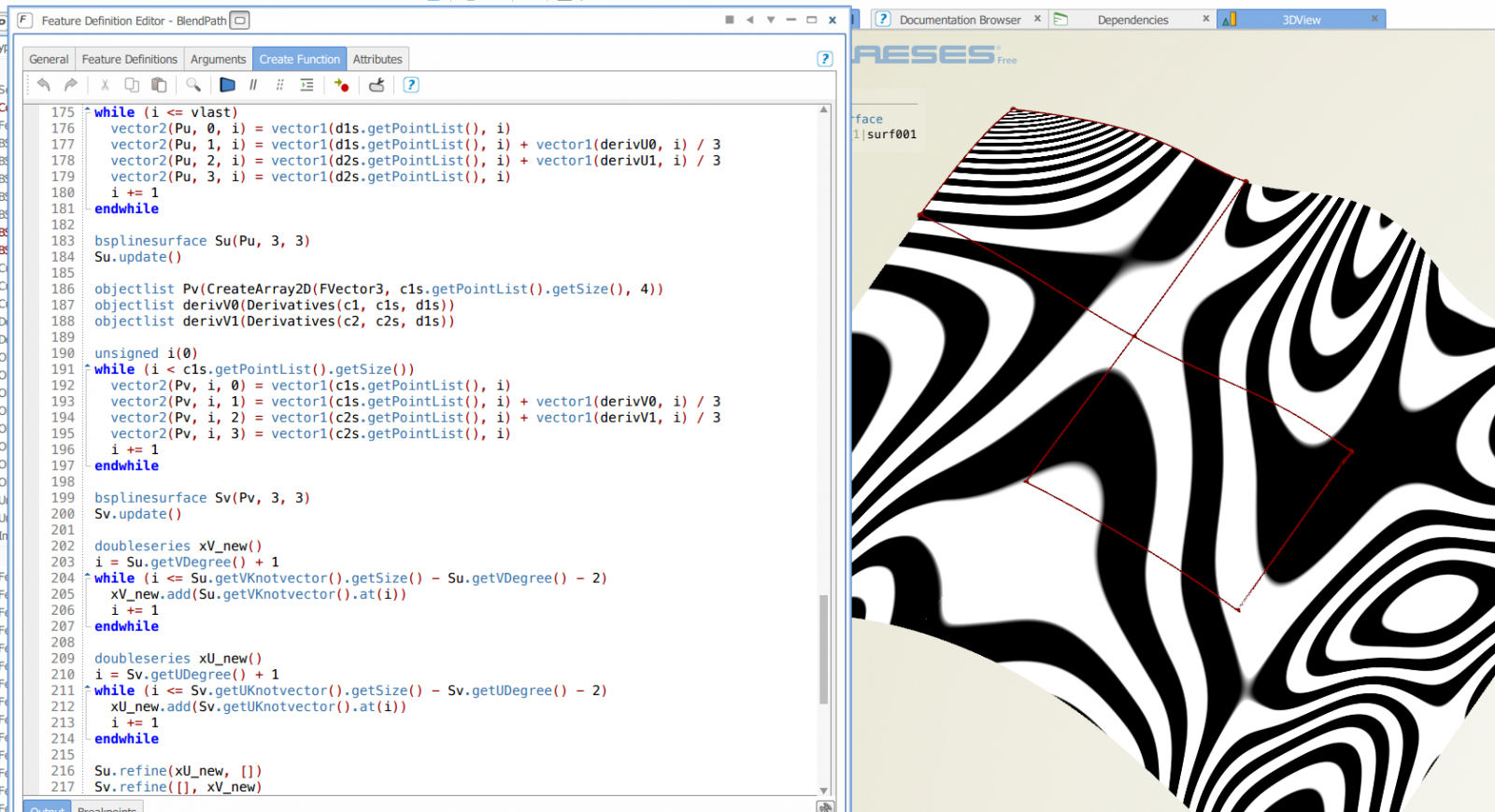

This is absolutely a working example. Realization of n-dimensional arrays. Well, for one thing, an expanded version of FInterpolationCurve. Good luck.
I'll build myself a very smooth curve angles and input data will generate the surface. If you roll the surface there is visible emissions and without curvature
