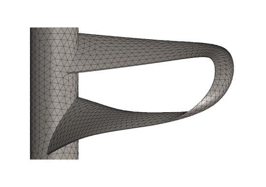

Hello,everone. Is there a good way to establish the profile "NACA66 Thickness form + a=0.8 mean line Camber" ,the usual profile that used in propeller design ?
I am a postgraduate student majoring in marine propulsion, and I find some problem when I try to use the Propeller Free Format(PFF) file. I want to establish a blade model by importing a PFF file, however, I have no idea about expressing the skew parameter of the propeller in a PFF file. I have downloaded the demo PFF file fromhttps://www.caeses.com/blog/2017/introduction-to-pff-propeller-free-format/#respond, and the skew is not presented in this file. So how can I figure out this problem.
Best regards.
