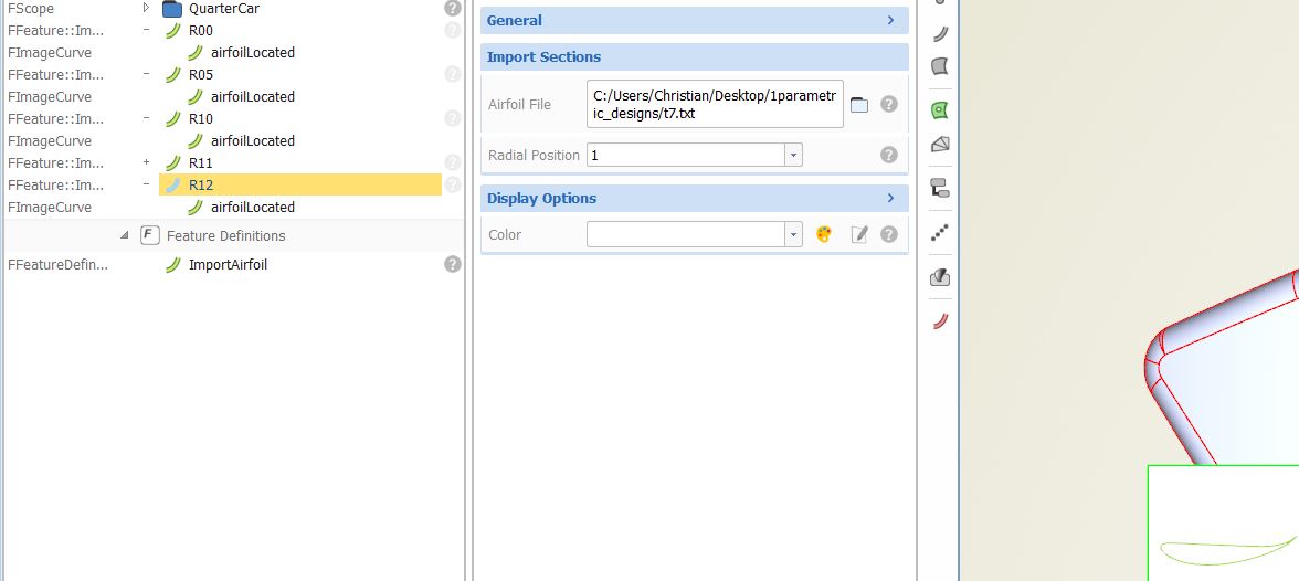

So I followed tutorials to import my IGES geometry, import the airfoil data points and also parametrize the curves via scaling/translation/rotation. This allows me to use the pre-existing geometry as references and create the airfoils within Caeses. Now I am interested in parametrizing the generated FImageCurves of one of the multi-elements and optimizing the airfoil profile (so the actual FImageCurve).
EDIT: I parameterized the airfoil combinations, included other geometry etc. and manage to have CAESES output working IGES files for use in StarCCM+. Now I have to run remotely on a browser based cluster (difficult to remote from local pc). Also results will be too large to download unless its a csv file or only have to download few times per sample size (i.e every 5 valuations create a new Ensight file to import from highest downforce candidate). I ran an Adjoint Sensitivity baseline. I plan to use this for the initial baseline sensitivty for the Dakota Optimisation method. I generated 25 designs with a blank baseline for downforce and I restricted the geometry to test if the random design samples were all feasible designs. My question is do I need to run the CFD, the Adjoint Sensitivity responses and export an Ensight file with those results for every design generated or can I simply export after a mesh/run from StarCCM+ a net total downforce evaluation in a .csv file of the corresponding design iteration and import that into CAESES? Wasn't entirely sure from referencing tutorial how to import the csv for design iteration XX's downforce evaluation.
I can connect to StarCCM+ up until the mesh/run case with macro. Cannot do mesh/run locally nor remote connect locally.

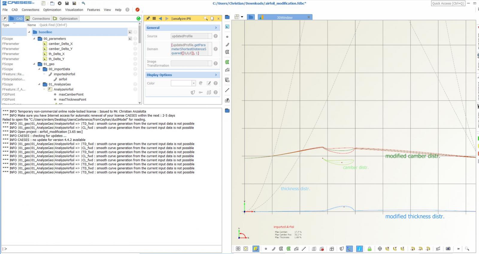

What you you have to do first is to redefine the airfoil curve as a combination of thickness distribution and camber distribution curves.
Parameterizing these two curves in an automated way would provide you a way to approach your goal.
Let me prepare a simple project where one can read point cloud data; convert it to an interpolation curve; redefine it as camber distribution and thickness distribution curves and finally parameterize those curves in a simple and easy way.
If I find time today, will be posting here.

Hi Christian,
Please find the attached project.
Please note that this is rather a simple case that can further be improved.
Please let me know if you have further questions.
The feature that reads the point data needs a file where x y z coordinates are provided only. You can modify the feature with respect to your needs.
Ceyhan

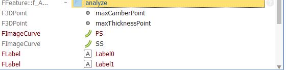

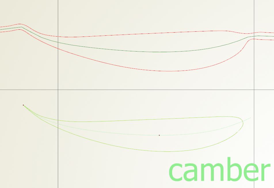

Thank you for the file. I am running through the file to better understand the setup, etc so I used this dat file which I can provide.
I tried using two other .dat files I generated in the format you mentioned, but seems to have some error when solving for the pXmax and camberline/thickness. Let me know if you find a solution before me!
Currently, I'm attempting to use the definitions you had within the file you sent and implementing into my current sim where the airfoils aren't have issue in generating the imported FImagecurve.  Thank you for the quick setup and advice as well very helpful I can see myself generating designs by the end of the night or tomorrow at this pace.
Update: Thank you it has implemented the airfoil I added the appropriate Z column data and worked flawlessly.
Update2: Now only concern is the leading/trailing edge and the updated PS had a minor issue. Let me know what you think could be the issue.

Hi Christian,
When I deal with an airfoil I always start with one that has a chord length of 1.
So in most databases the airfoil point data has an aligned chord to x-axis that has a length of 1, starting from 0 and ending at 1.
You can either modify the feature "parameterize curve" to fit into your dimensions, or scale the airfoil data so that it has a chord of 1 and aligned to x axis.
Ceyhan
