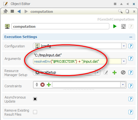

Jörg 29 Report post Posted May 16, 2013 In some situations it is required to have access to the current project or design directory (e.g. when connecting other software tools and you need to know where the exchanged files are located). These paths can be received by the following global commands: env() resolveEnv($PROJECTDIR) resolveEnv($DESIGNDIR) Alternatively, the following is also allowed: resolveEnv("$PROJECTDIR") resolveEnv("$DESIGNDIR") The first command env() can be simply typed into the console in order to see all environment variables.The two other command examples return a string of the corresponding path. Such a string can be used e.g. as argument string for a computation (see the attached screenshot) or at any other place where a string (type FString) is expected. Share this post Link to post Share on other sites
