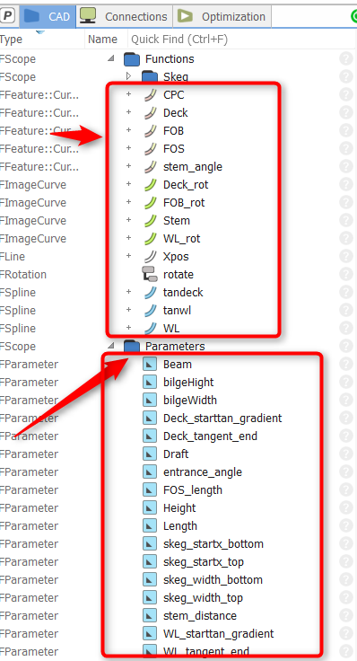

Hi friends, I'm working on my thesis. I am designing a parametric yacht in my thesis. I used Fast Monohull in sample design. I have to change the value of most points. But all of them are not ACTIVE, So I have not changed. Do you have any idea about that? Thank you for your interest.
Hey,
You cannot change the points directly. you need to change/adjust the Parameters in the scope "Parameters".
If you change their values the ship hull will be updated.
In addition you can also try to change the curves in the scope "functions"
Hope this helps.
