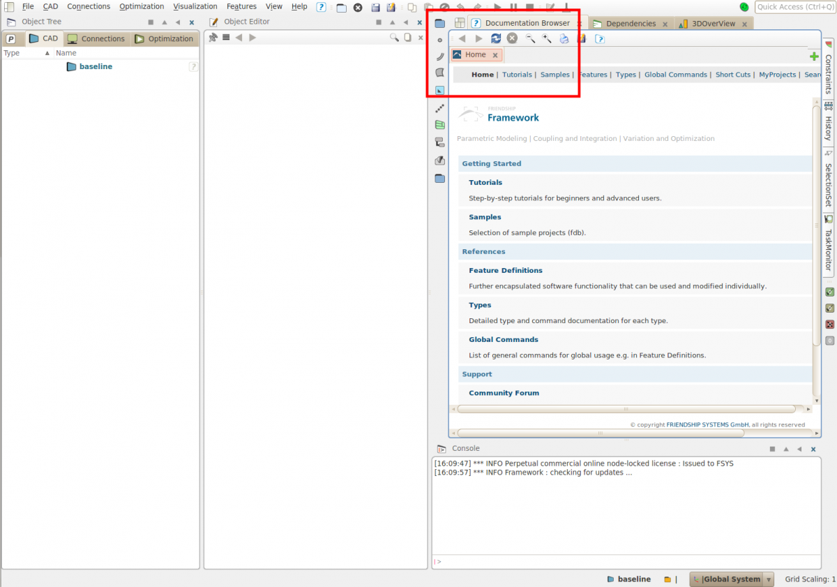

Karsten Wenzke 12 Report post Posted April 30, 2013 Hey,if you try CAESES for the first time or you want to learn more about it. You'll find a bunch of tutorials and samples included in the Software. PDF TutorialsGo to the Documentation Browser and click on Tutorials or Samples. The tutorials will help you to get through all features CAESES offers. After doing theses tutorials you' ll be able to start creating your own projects. Sample Project FilesThe Samples are finished projects which can be edited. Video TutorialsSee this page. Feel free to share your models with us in our forum. Feedback w.r.t. the tutorials is highly appreciated.Regards,Karsten 1 Share this post Link to post Share on other sites

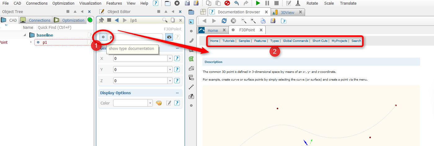

Karsten Wenzke 12 Report post Posted November 4, 2014 Hey Jaime, unfortunately there is no extra userguide or manual for FFW. But each object type (points, curves, trimesh, ...) has an own documentation in FFW. You can access the type docu by clicking on the object type symbol (1) in the Object Editor, use the Documentation Brower > Types (2)or use the Search in the Documentation Browser. If you need any further information or more details please let me know. Cheers, Karsten Share this post Link to post Share on other sites

Mr. Thomas Moritz 0 Report post Posted November 20, 2015 Hi,I installed Version 4.0.3 on Linux Mint and want to do the tutorials.Unfortunately, when I go to "Documentation Browser / Tutorials / Getting started" the links below e.g. "Graphical User Interface" do not work.What can I do?Regards,Thomas Share this post Link to post Share on other sites
Karsten Wenzke 12 Report post Posted November 20, 2015 Hey Thomas, You can find all tutorials in the CAESES installation folder/tutorials as well. Cheers, Karsten Share this post Link to post Share on other sites
Mr. Thomas Moritz 0 Report post Posted November 20, 2015 Thanks Karsten, found the PDFs. Thomas Share this post Link to post Share on other sites
