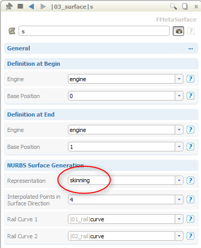

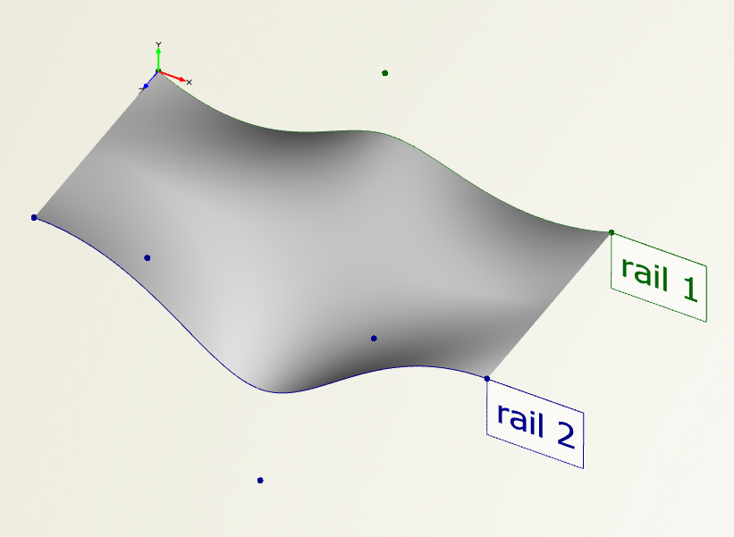

Jörg 29 Report post Posted August 28, 2014 Hi together, With version 3.1, you have the additional skinning option for meta surfaces. This allows you to have a low number of generating cross sections (curves in surface direction) while matching given boundary curves, also called rails. See the attachment for a simple example. In former versions, one solution to approximately match such boundaries has been to increase the number of cross sections - which is expensive and increases the data of the resulting NURBS surface. Here, this new skinning method is a good alternative to the existing auto-cubic point interpolation. Finally, when it comes to the new BRep type that also comes with version 3.1, it is even recommended to exactly match boundaries for further processing such as Boolean Operations and fillet modeling. CheersJoergmetasurface_skinning.fdb Share this post Link to post Share on other sites
