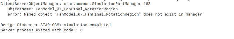

I am currently running in to a couple issues regarding the connection to STAR-CCM+ for optimisation. I have followed the tutorial guides and tried to troubleshoot on my own but with no success.
When running the Java Macro/connector 1 in the connection tab, an error of not finding the part is returned, yet it is the same in the simulation file used for input files. An image of both have been shown below, please let me know if more information is needed from my side.

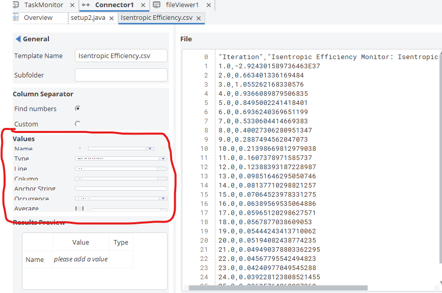

Also, when attempting to select the data values in the results values. The values section is completely uneditable, im not able to select anything and it seems to be stuck, is there a way to zoom out here?
