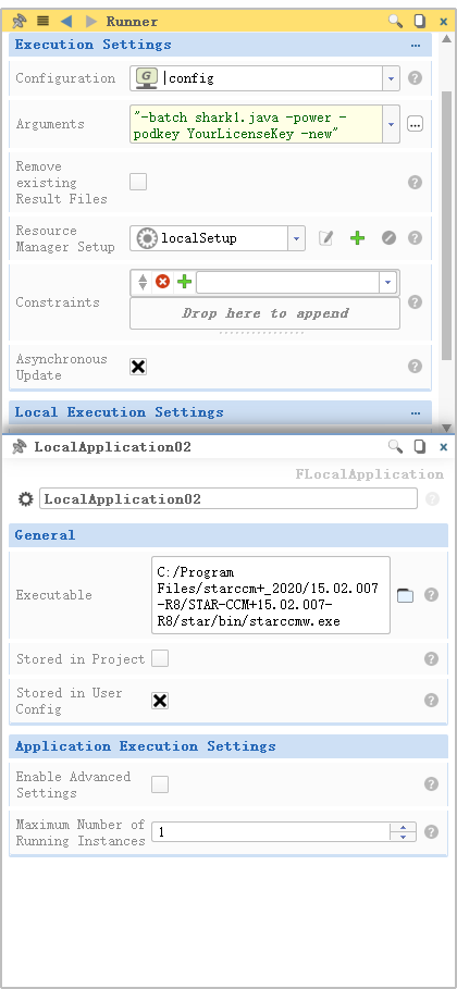

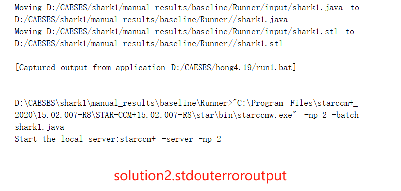

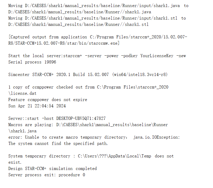

cui 0 Report post Posted April 21, 2024 Hi, when I connect with .java and starccm+, I get an error after running it. I checked the file location of starccm+ and there is no problem. I also tried the second approach, replace LocalApplication_executable with a .bat, the details are as in the picture, and after clicking run, he will stop at this start starccm+ server step, and continue to run without ending the program, and there is no error reported. How to solve this problem? Share this post Link to post Share on other sites
Weber 1 Report post Posted May 3, 2024 Hi cui, I am not really sure what the problem might be since I don't see your whole connection set-up, but it seems there is an issue with the creation of the temporary directory. Instead of your current argument in the connector try to use: "-batch shark1.java -np 2 -rsh ssh -power -licpath 1999@flex.cd-adapco.com -podkey <<insert your podkey>>"+ getResultsDir() +"/<<insert your simfile's name>>.sim". It also seems that in your current argument, the podkey is not inserted. Instead of "YourLicenseKey" you need to insert your specific key for using StarCCM+. Kind regards, Johannes Share this post Link to post Share on other sites
