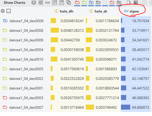

Yukai 0 Report post Posted March 12, 2024 Hello!! How should I set constraints so that CFD will not run when the slpoe parameter is greater than 45? Let CFD only performs the parameters I want Thanks for yours help !! Best Regards YuKai Share this post Link to post Share on other sites
Mr. Heinrich von Zadow 12 Report post Posted March 12, 2024 Hi Yukai, you can set up an inequality constraint and use it in your Software Connector under Execution Settings for that. Cheers, Heinrich Share this post Link to post Share on other sites
Yukai 0 Report post Posted March 14, 2024 On 3/12/2024 at 8:27 PM, Mr. Heinrich von Zadow said: Hi Yukai, you can set up an inequality constraint and use it in your Software Connector under Execution Settings for that. Cheers, Heinrich HI Heinrich, Thank you for your reply, I will try it. Best Regards YuKai Share this post Link to post Share on other sites
