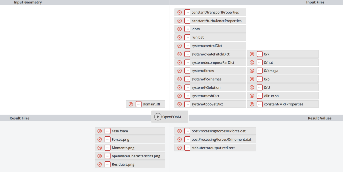

Hello
I am just trying to test "PitzDaily" case of openFoam in CAESES but it not showing any result but at the same time I am running those cases in local termial, it shows result.
I have tried to capture the blockMesh but nothing is captured in file.
Please help me regarding this.
Regards
output.txtAllrunstdouterroroutput.redirect
pitzDaily.zip
Hi yuvraj,
I have reviewed the CAESES project and observed that in the "Connection" workspace, the OpenFOAM files are not properly oriented within the directory system, 0, and constant.
Please refer to the attached photo to understand how a proper integration OpenFOAM with CAESES should be established with the appropriate folder structure.
Furthermore, you may find a helpful demonstration in an older video from us that illustrates the setup of such an integration: https://www.youtube.com/watch?v=dB9sQxZxqTY
image.png.0e2625958f31e5703b131d5ff9c0d8fe.thumb.png.f7a7ab78c08430f1939ea530222cc41c.png

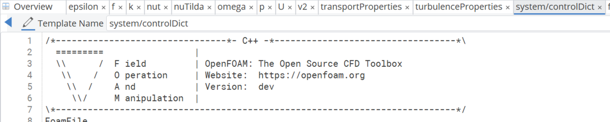

To correct this, you can open the file in CAESES and specify the correct Template Name as seen in the picture below.
Ensure that these changes are applied consistently across all relevant files.
Additionally, it's essential to understand the significance of the system, 0, and constant directories in OpenFOAM.
You can explore the following link for a detailed explanation: https://maplekeylabs.com/understanding-the-openfoam-case-structure/
Please let me know if implementing these adjustments resolves the issue you were experiencing.
