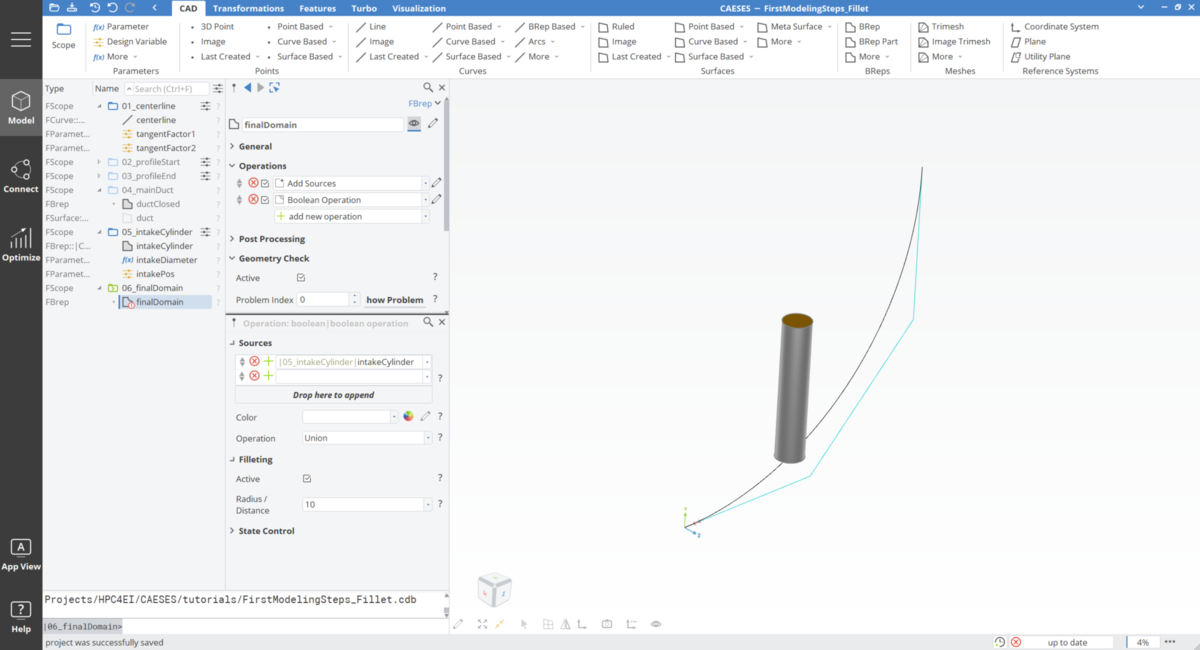

KNL21 0 Report post Posted January 19, 2023 Hi, I'm a new user to Caeses and have been working through the "first modeling steps" tutorial available here to get familiar with the software: https://watch.caeses.com/w/1vmuNq5DMJoyecvp9Xk6uA I'm having an issue with the last step in the "final domain" portion, where a fillet is created from the two brep's for the intakeCylinder and ductClosed, respectively. When I activate the filleting option and enter any value in the "Radius/Distance", no fillet is created but instead an error comes up that the filleting operation failed and the duct geometry is no longer shown (see image). I've attached the project file here as well. I've gone through the tutorial several times now and seem to be following the steps correctly for the last segment, but I haven't been able to debug this issue myself yet. Any help or advice would be greatly appreciated. Thank you in advance! Best, Katherine FirstModelingSteps_Fillet.cdb Share this post Link to post Share on other sites
Mr. Heinrich von Zadow 12 Report post Posted January 23, 2023 Hi Katherine, thank you very much for the hint. This seems to be a bug -- you can get it to work if you "rotate" the profiles (i.e. just add the 4 separate parts in a different order). We'll pass this on to our development and make sure it is fixed with the next maintenance release. Cheers, Heinrich Share this post Link to post Share on other sites
