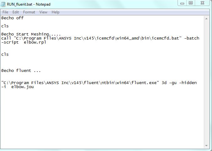

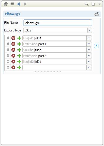

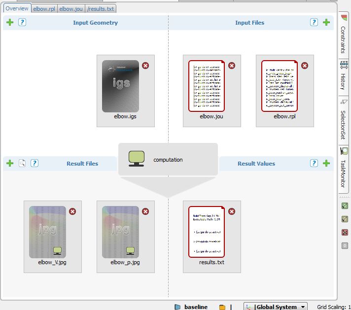

 Please find attached a copy of my project file. its a simple meta-surface elbow i designed with an ellipse curve.Functions for the "width and "height" of the curve are defined. you can have a look at how parameters are set from function curves. I used ICEMCFD as my meshing tool and Fluent as CFD solver. specific files such as the *.rpl and *.jou were used as input files( checkout the attachments).
Absolute paths should be changed to relative paths via "getdesigndir()...." (not all paths are necessary!). A *.bat file, RunFluent.bat, was used to run both ICEMCFD and Fluent in batch mode. Snapshots, graphs etc from fluent can be included as results files for post processing. Details on post processing can be found in CAESES tutorials " getting started".

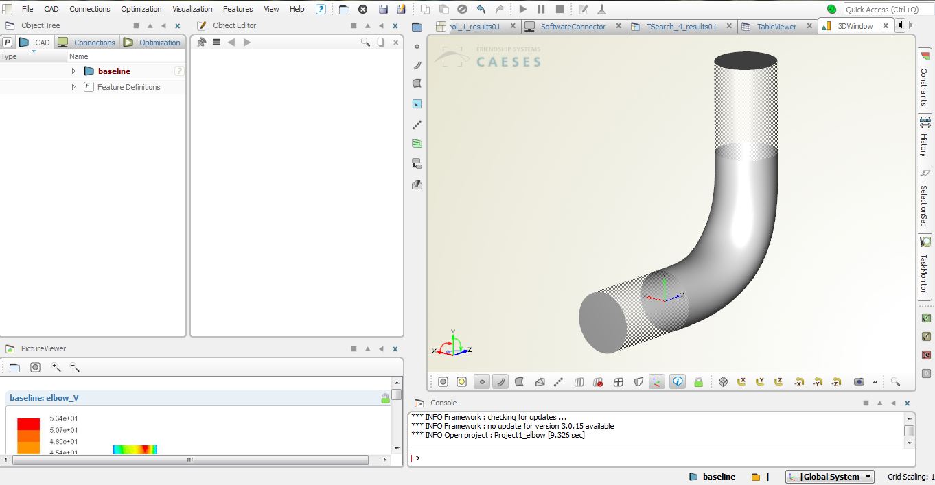

I've reset my license to CAESES and it works perfectly well. ( check out snapshot )
I think  *.fdbc project files are for non-commercial and Free Editions unlike the *.fdb which is for commercial editions. so i think  it should work. Ive attached it again using CAESES. you can give it a try.

Thank you for this example. It was very helpful in connecting CAESES with Fluent and the Mesher I am using (Pointwise) together. I am wondering if using a batch file is the only way to connect the two together. My first attempt was to create two separate connections for Fluent and Pointwise but I was unclear on how to get them to run sequentially, mesher and then solver.

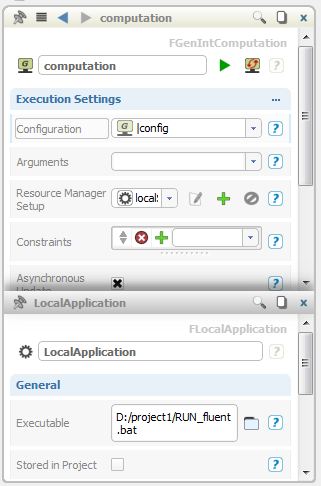

2) When I try running a Sobol engine to conduct a design study it runs Pointwise to mesh the first one, then runs fluent to solve it but starts running pointwise again and then fluent again for the second design before the first one has finished solving. This causes several instances of Fluent which drastically slows the computation down. In addition to this the evaluation parameters give nan values. I tried it with asynchornous update on and off and specifying the maximum number of running instances of the local application which is the batch file. Any ideas on how to get CAESES to wait for Fluent to finish solving the first design before starting to mesh and solve the second design? Is it the batch file which effectively finishes once it starts Fluent so it begins the next one? I have tried using START /wait in the batch file in stead of call but that has not worked. Also why are the evaluation parameters not updating?

In order to make sure that two connectors run in a fixed order, the second one (in your case fluent) needs to be dependent on the first one. Please see the second to last post in this thread: https://www.caeses.com/forum/index.php?/topic/303-connection-with-cfast/ for how to accomplish that.

2) Actually, being able to calculate multiple designs at a time is a functionality of CAESES, so it behaves as it is supposed to. In general, if you want to make sure that only one computation runs at a time, it is the most efficient to disable "asynchronous" update for all your computations (in your project the computation "Runner" is set to asynchronous update).
