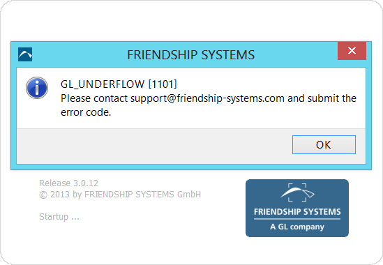

Error message: GL_UNDERFLOW [11xx] while starting CAESES
Hey,
You have received the error message GL_UNDERFLOW [11xx] while starting CAESES?
Then you have to adjust  your local time setting of your system.

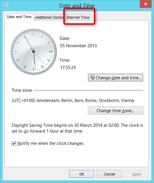

  1. go to "Date and Time"

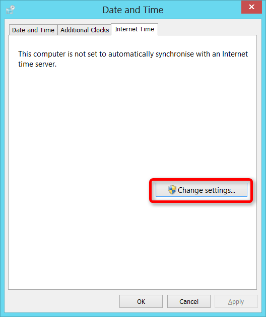

  3. click on the button "Change settings"post-41-0-82891300-1383731438_thumb.png

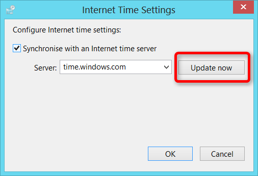

  4. check the selection box "Synchronise with an Internet time server"
