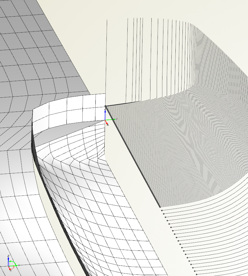

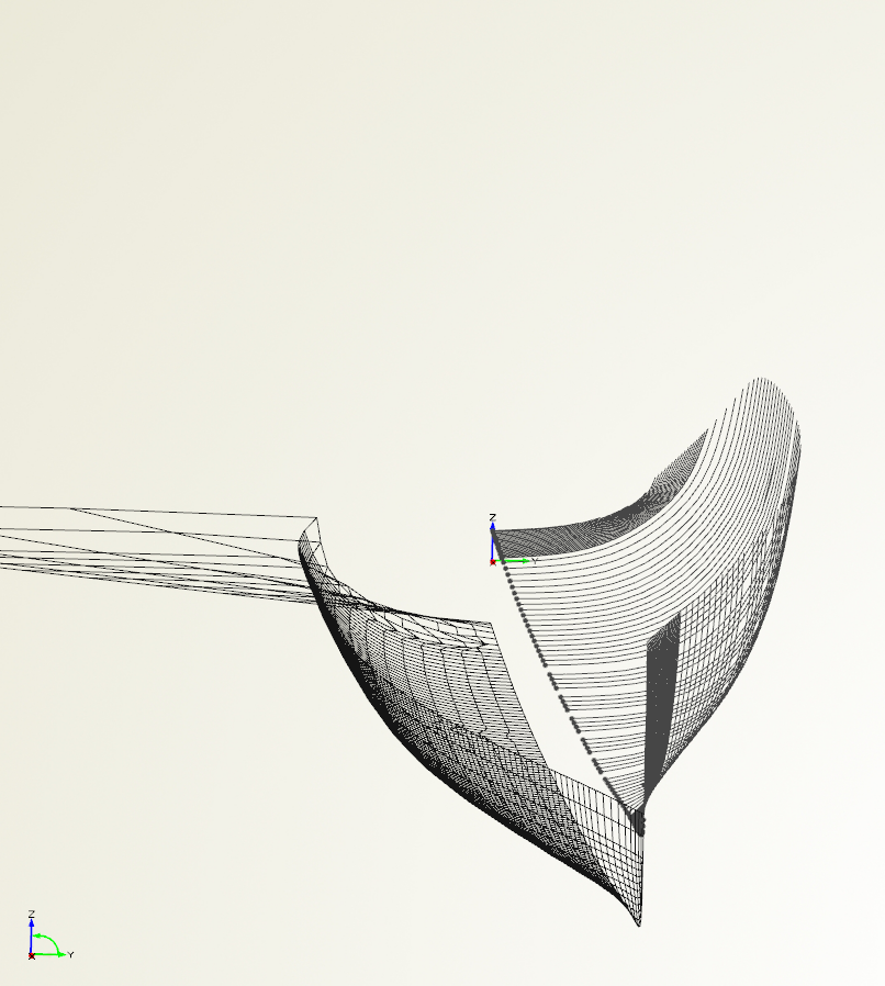

I still have problems running the model. The boat I want to analyse has a curved transom which is half immersed. When I set the shiptype to mono the mesh at the hull/transom-edge is corrupt and the watersurface cuts through the hull at the stern. Is there a way to generate knuckle lines on the hull or is there another way to define a curved transom?  When I set the hull type to yacht it doesn't finish meshing.
I also tried to cut the offsets at the hull/transom-edge, but in this model the meshed hull at  the stern is corrupt.
I uploaded screenshots for better understanding the problem.
